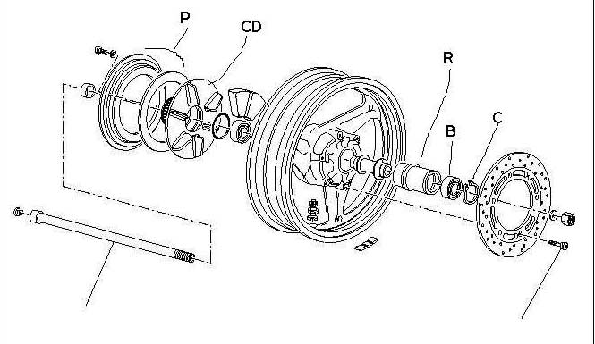

jrt Posted September 21, 2003 Share Posted September 21, 2003 I was messing around today, dropped the rear wheel, and I was going to grease the cush drive (CD and the rubbers, of course) a la Rich Maund (he's such an inspiration ) Anyhow, I got all the screws out and the big washer off (P) and the manual says to drive out the bearing from the other side then remove the plate (CD). At that time the cush drive is accessible. It's literally that vague. So, do I drive out that whole inner race-thingy ® or do I actually just remove the bearing? I've got the giant circlip © off and should I just pound out that race? thanks, Jason Link to comment Share on other sites More sharing options...

jrt Posted September 21, 2003 Author Share Posted September 21, 2003 Yeah, we're on the same page. It's that sentance 'working on the opposite side, remove the bearing and then lift the plate with gearing 'I' using two screwdrivers' that bothers me. The bearing doesn't come out easily - and I don't want to destroy the bearing trying to get it out if there's some easy trick to doing it. So I was wondering if that whole race came out. Thanks Geezerx. J Link to comment Share on other sites More sharing options...

RichMaund Posted September 22, 2003 Share Posted September 22, 2003 Folks Getting the plate off with the two screw driver trick works to get into the rubbers. Often, if the rubbers are assembled dry, as they usually are, that plate will stick. Just keep patiently working at it to get it free of the rubber blocks. But you must drive out the hub from the wheel to apply grease to that area. There is even a spiral groove machined in to hold the grease there. I found Guzzi assembled mine dry. Unless that area is greased, it can lock up and then no relative motion is allowed to occur between the wheel and hub. "Usually", you can drive it back from the large circlip side with a hardwood dowel and a mallet. Block up the wheel to allow it come back through the other side as you pound on it. If yours is a sticky bastard, as mine was, you're better off putting it under a large hydraulic press. Feel free to use liberal amounts of your favorite penetrating fluid. ZEP makes a professional grade one that is excellent. Good luck on it. It's worth doing. Link to comment Share on other sites More sharing options...
Guest geezerx Posted September 22, 2003 Share Posted September 22, 2003 Hi Rich, thanks for jumping in here. So, I think I'm clear on the rubbers now, but am not so sure that I'm understanding about the hub. Seems that when I removed the "plate with gearing" so as to access the rubbers, the section of hub on which the plate must be free to move was exposed and I greased that section. But I assumed (not based on any training, knowledge or experience) that movement between the hub and wheel would not be desirable??? Link to comment Share on other sites More sharing options...
RichMaund Posted September 22, 2003 Share Posted September 22, 2003 OK, I was thinking wrong on this. Sorry for that. The hub needs to be a light press fit into the wheel. No movement wanted there. The plate that engages therubbers needs to be able to move on the hub though and you did grease that area. Good! I got confused remembering it since I had to completely disassemble my wheels way beyond just servicing the cush drive in order to get the wheels powdercoated. Taking that plate off and lubing the rubbers with silicone dielectric grease and using #2 lithium grease on the hub to plate contact area is all that is needed to make the cush drive do it's job well! Link to comment Share on other sites More sharing options...
jrt Posted September 22, 2003 Author Share Posted September 22, 2003 Thanks guys, My 'plate with gearing' is being obdurate- I don't want to bugger up the rim with screwdrivers by levering on it. Since the hub is also pretty well stuck in there, I'll press it out and grease it too. cheers, Jason Link to comment Share on other sites More sharing options...
