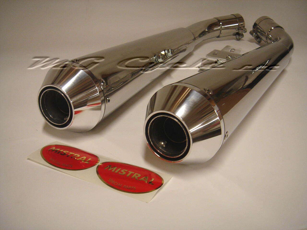

Tom M Posted January 1, 2010 Share Posted January 1, 2010 I like it. I've been struggling with the exhaust for my '81 Tonti cafe project, and keep coming back to reverse cone megaphone. I'm willing to step up in price (since the entire project has become for me an exercise in tossing money down a very large hole) - however, I haven't found anything that is much better than the Roadhawk or near-equivalent. Higher end options (MIVV xcone for example) are lighter and maybe quieter, but very costly and still have a bit too contemporary look. You chose a great length for your Paul Smart, they look great and seem a bargain. Questions: Are these stainless under the chrome (I presume so), and have you given thought to removing the chrome and giving them a brushed look (something short of polished). Did you (or anyone) have a quieter and not chrome megaphone option? (Supertrapp with reverse cone ends and MIVV are close but not quite what I'm after). By the time you add two good quality slip on mufflers, its cost effective to have Price Sloan fab the thing as near as I can tell. MG cycle now has Mistral reverse cone meg's for the V11. You can add the supplied "db killers" if they're too loud. Maybe they could source a set for your Tonti? Here's another source for cheap reverse cones: http://www.mikesxs.net/products-44.html Link to comment Share on other sites More sharing options...
fotoguzzi Posted January 2, 2010 Share Posted January 2, 2010 MG cycle now has Mistral reverse cone meg's for the V11. You can add the supplied "db killers" if they're too loud. Maybe they could source a set for your Tonti? Here's another source for cheap reverse cones: http://www.mikesxs.net/products-44.html yikes! over 600.00/ I'll be sticking with stock or some cheapies.. plus they look too high for my HB bag mounts. Link to comment Share on other sites More sharing options...

Lamedog Posted January 2, 2010 Share Posted January 2, 2010 MG cycle now has Mistral reverse cone meg's for the V11. You can add the supplied "db killers" if they're too loud. Maybe they could source a set for your Tonti? Here's another source for cheap reverse cones: http://www.mikesxs.net/products-44.html Tom: Thanks for the link to Mike's - These help. The Mistral's are a bit long for what I'm after but they are pretty things. Link to comment Share on other sites More sharing options...
