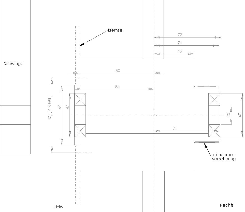

One other thing to warn about: the guys building the MGS01 replica orderd wheels for their centauro/V11. The wheel fit's great but wasn't in the center. almost 15mm to the left. I made a drawing of the wheel when I ordered it. Mine is exactly in the middle.

jm the wheelhub is build from sperate parts, I suppose they make the part on the reardrive side a bit shorther. One of the austian guys send the wheel back, I will ask if its solved now. This is what I send them, the brakeside will be different, because I made my own thing for it. Center wheel to left inside swingarm is 132mm. Shockcenter is bikecenter, so a piece of wood against the tyre on both sides, should measure the shock in center.

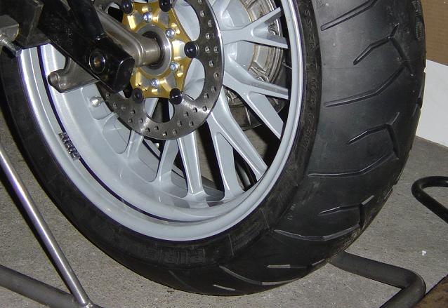

i will go to the garage today if i could face the snow storm outside : <_>
Will take a picture also ...
amn if i must send it back !
