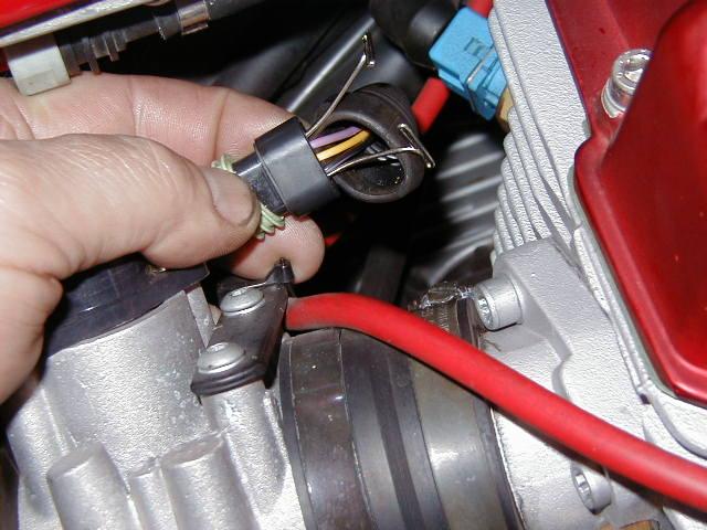

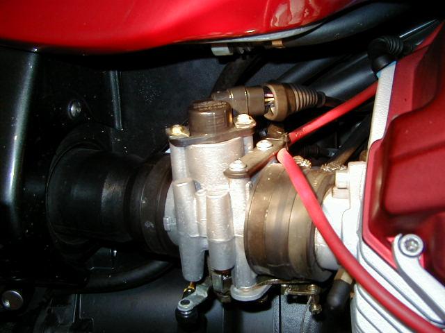

To check your TPS voltage I do the following.
1. Locate the tps sensor on the right side of the throttle body, slide the boot on the connector down to expose the wires. I remove the connector from the tps and then nsert a T pin (even a sewing pin should work) into the rear of the connector (back probing) where the wire comes out of terminal A and also at terminal C. The pin slides down against the connector terminal. This is better than piercing the wire! Also make sure that the ignition switch in the off position!

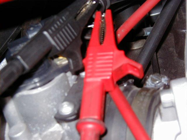

2. reconnect the connector to the tps. You must keep the pins seperated, I usually bend them slightly to advoid any contact.
3. Connect your voltmeter clips to the pins. Negative goes to terminal A and the positive clip to terminal C. If you get it backwards the tps reading will still be correct but will have a - (negative symbol infront of the reading).
4. Make sure the fast idle lever is turned off. Turn on the ignition switch and read the voltage. Mine reads .466 volts or 466 mv. What should your tps voltage be, I am not sure. Between three of my bikes, they range from .268 to .650 volts. They all run fine :huh2:
