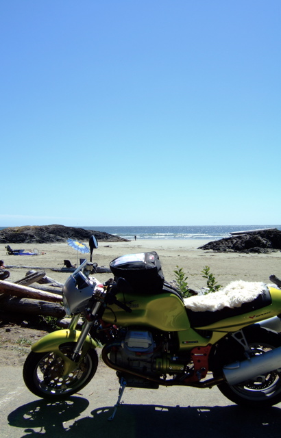

We just got back from a weekend trip to Vancouver Island British Columbia and I can tell you that when you ride with a passenger on a V11 it won't be too comfy for either one of you. My wife figures that becase the seat is slanted forward and the passenger pegs are high it is difficult for her to keep from leaning on me. She tries to brace herself on the tank when she can but you can't maintain that for very long. The road to Tofino on the West Coast was very twisty, I got to ride it on the way there solo, and we rode it back two up. 140 km of motorcycle riding bliss.Guzzi_LongBeach.jpg
