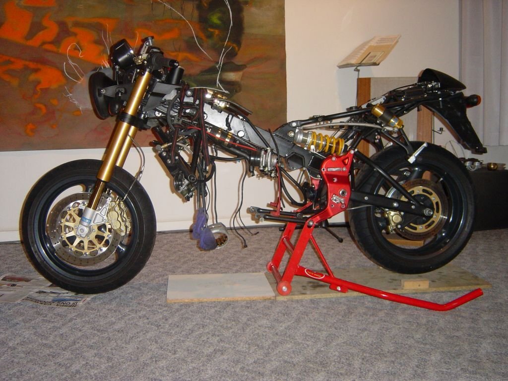

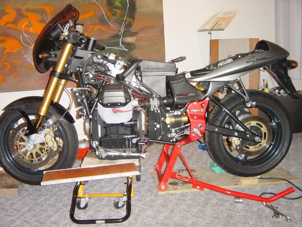

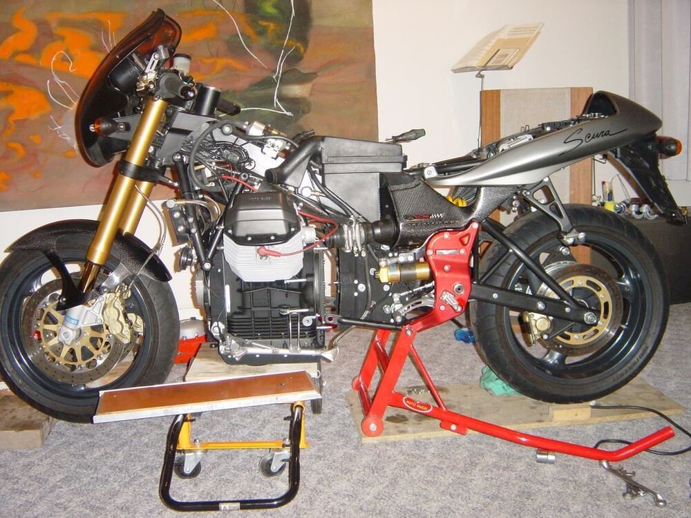

there are ( at least) 2 ways to do it.
1. leave the engine mounted in the frame and take the gearbox away.
problem with the >2001 bikes is a bit the subframe between gearbox and swingarm.
2. leave the gearbox and take the engine to the front.
For only the clutch this one is easy I think, look at the picture here. The engine can be taken away in this position, As you see the engine is on a wood piece on wheels that has the right height.
If you ask your dealer for 2 special tools: the one that locks the clutch, and the tool to block the gearbox spline, then you don't have to take it out no more than this. Else in the position like on the picture, you can take the engine sideways out.

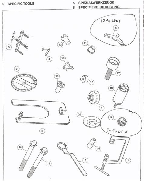

Have I got the right items circled on this special tools schematic?
Don't want to order the wrong kit! :homer:

the first tool is, the second you don't need, you can use the one you have in your hand, the one that mounts on the gearbox. And to lock that, I suppose you need nr 8 in the picture.
To get the old one of, you can use a spanner, no problem when it's ruined.
Maybe your dealer will rent you the tools?
