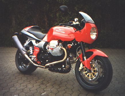

Mike Stewart Posted August 27, 2005 Share Posted August 27, 2005 Anyone out there seen a V11 with an LM1 fairing? I'm thinking it might look cool with the cafe direction I want to go with my scura, but would like to see a photo or something. Imagine pod air filters, no hugger, undertail cleaned up, Bubs, and the LM1 fairing. Looking for the retro/modern cafe thing. If not, gotta go with the V-Rod headlight and no fairing... dk 58167[/snapback] You mean like this: , This has been around for years, the stock LM1 fairing will not fit with out major work. Been there, done that. Mike Link to comment Share on other sites More sharing options...
Guest drknow Posted August 27, 2005 Share Posted August 27, 2005 Mike, what was the major work you had to do? Is the one in the picture stock, as I can see the bottom has been modified... dk Link to comment Share on other sites More sharing options...
Admin Jaap Posted August 27, 2005 Share Posted August 27, 2005 Original LM 1 fairing won't fit! Fairing on the picture is an item specially made for the V11 by German Guzzi dealer Inteam. Last year I ordered one. It never arrived. They aren't Guzzi dealers anymore and I have yet to see a refund... <_ so much for jerry...> Link to comment Share on other sites More sharing options...
