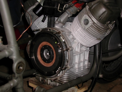

Yep. It's already assembled, so it just needs to be bolted onto the crankshaft. The bolts were supplied with the clutch. It uses a special transmission input hub (also supplied) so that needs to be changed out as well.
