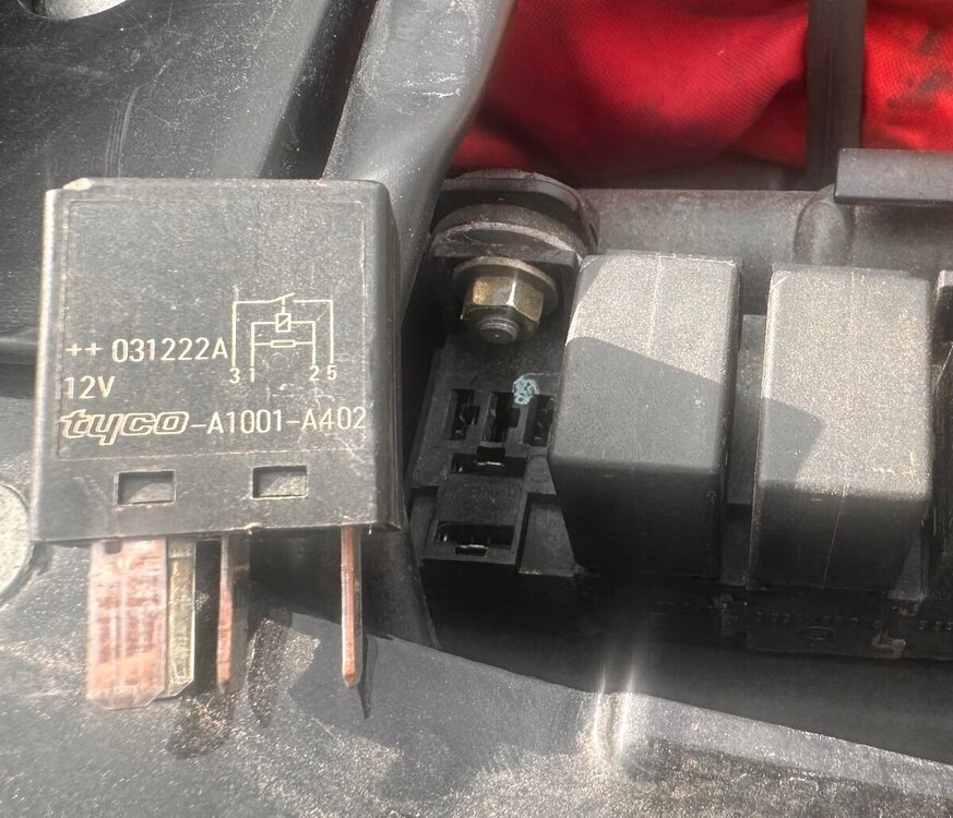

  2. Indeed. It is running perfectly now. Easy enough to take a peak at the switch, so I will probably do that. The corrosion on the relays and immediate resolution after reseating them explains the data for me. I hit all the relays with a contact cleaner. A friend nice told me that 95% of all electrical problems are bad connections. Looking backwards a number of decades now, he was right on target! This is a good prompt for me to go through and clean all of the easily accessed connectors. I gotta take the time the to thank everyone on this forum. Though I’m not particularly active, I would come back here from time to time and always found fantastic, well articulated advice by you(gstallions), docc, mickaudio, and countless others. I have posted only a handful of times, but that was because most of the answers I sought were addressed in previous posts. Thanks again, cheers.
  3. When I rode home tonight everything worked perfectly. I can only assume that taking the relays out, putting back in a seating them took care of the corrosion that was on them. You can see the green corrosion in the photo above. I was kinda bummed I didn’t get to test @audiomick’s theory, but happyhave have things running properly. Thanks all!

  9. Thanks for the input all. I have a little more data after my ride home tonight. It died again on me and wouldn’t even turn over. I toggled the kill switch on and off and it started right up. I repeated this four more times, spirited acceleration, bike dies, activate and deactivate kill switch, and it started right up. This seems pretty squarely electrical, but I’m not sure where to start now. Any suggestions?

  11. Hi there, I have a 2004 Nero Corsa that is dying upon hard acceleration. The problem goes like this: bike warmed up and runs fine on casual riding, upon a spirited goosing engine roars to life for a good second or two, then completely dies. I mean complete non-response as if I had hit the kill switch. After I pull over and wipe the tears from my eyes, it starts up again without hesitation. As far as I know the fuel filter has not been replaced, maybe this is a good place to start since it need to be done anyhow. Any other ideas? Any advice would be warmly received. Thank you!
