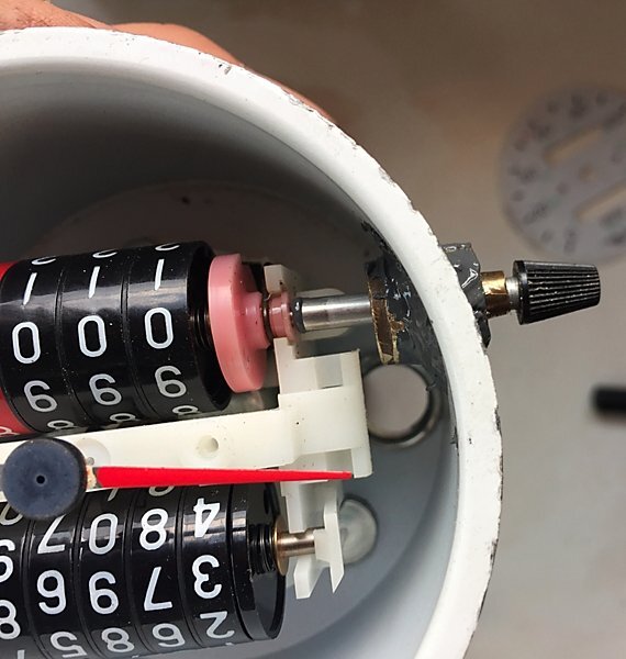

  1. One more bit of information. The enamel coating on the needle was separating and about to fall off. Getting this crap into the moving parts would certainly cause trouble.

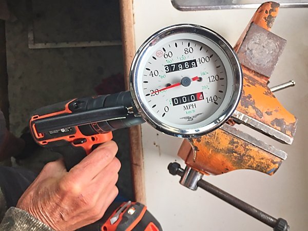

  3. When I got the bike the grommet was missing and the reset shaft was bent. Trip odometer not working. Bit of dirt inside. With 37,000 miles on the meter, everything inside looks like new. No plastic gear wear. After reassembly it all works when driven at 20mph with my drill. Looking forward to testing at 100mph when my regulator shows up.
  4. The shaft is now 3/8 shorter, but I've got a piece of hose to stick on the end. Added a bit of brass where a grommet probably once lived. As a bonus the white needle on a white background has been fixed???

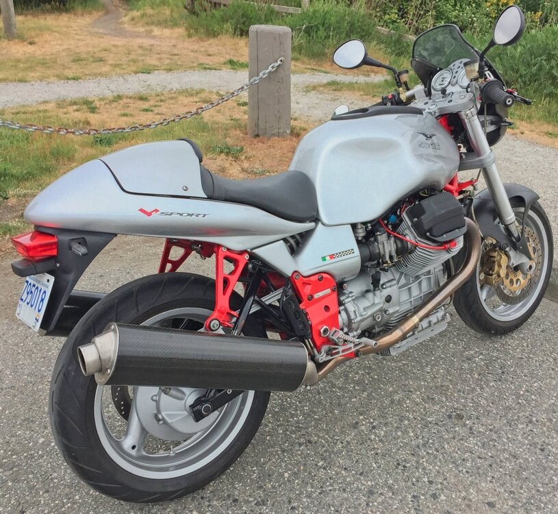

  7. Here's one more silver bike. Not sure why the front fender is black plastic.
