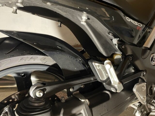

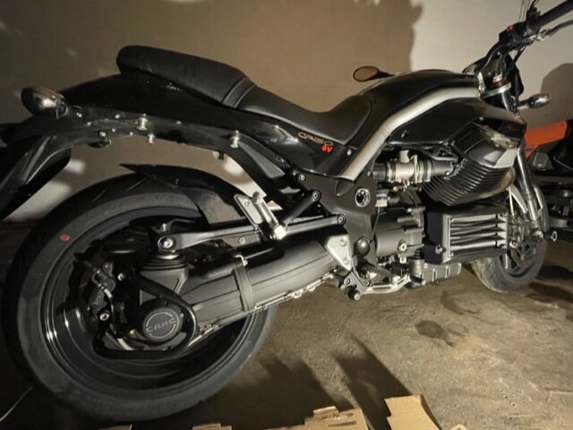

  14. Nothing doing with the V11’s today, I did treat the Griso to a carbon fibre hugger, which I was quite impressed with. Easy to fit, lightweight, looks good. Which reminded me to ask if anything was developing / progressing about the V11 carbon fibre pillion seat humps
