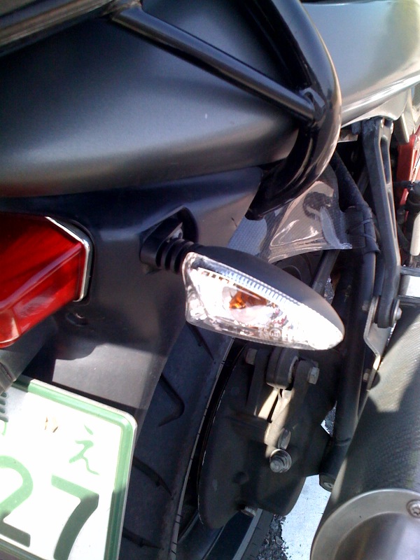

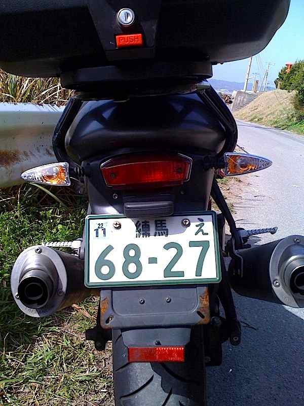

  11. new triumph street triple "arrow shape"turn signals fit bolt-on to v11s. purchased from jack lilley http://www.jacklilley.com/view_part.asp?ca...mp;part_id=5415
