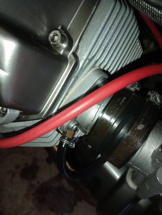

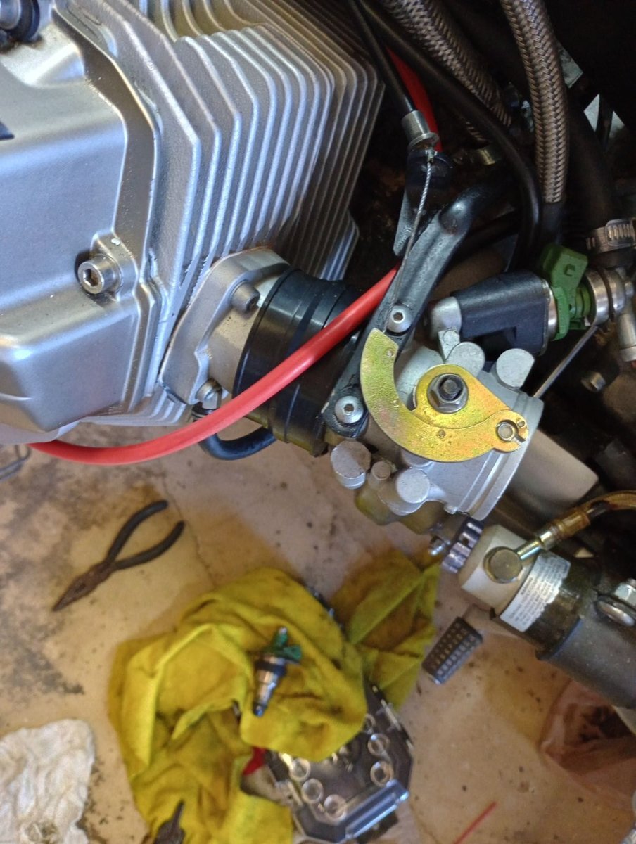

Thanks to both of you! It looked like I would still be off even doing it this way but this must be the solution. Thanks again!

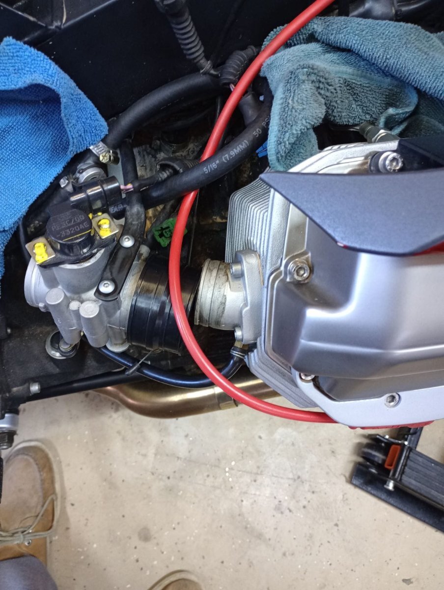

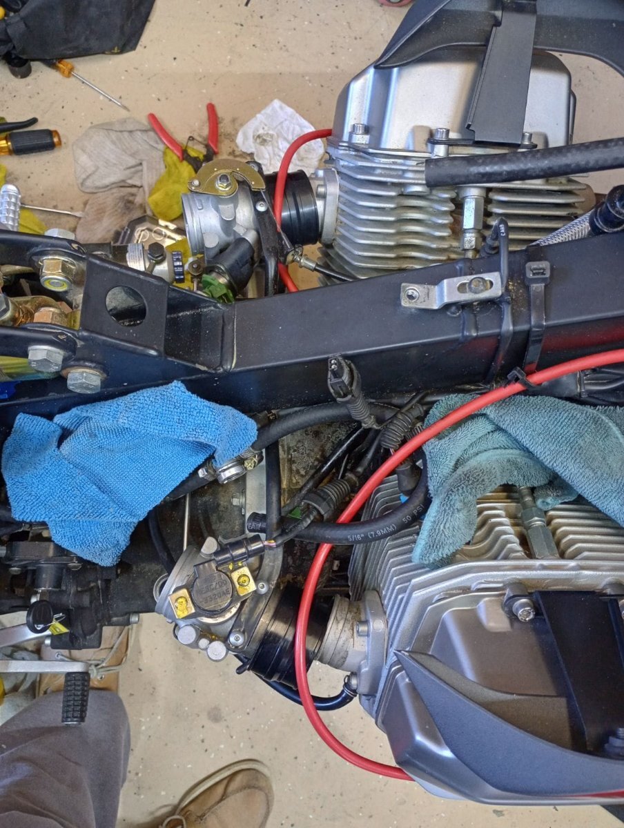

I replaced the rubber connector between the throttle body on the left side and the intake, and now find the throttle body on the right side to be way off. The previous owner addressed this by having the rubber inserted at an angle on each side, but I can't believe this is the factory solution. I could wrestle the right side in but both sides would end up exactly the way the previous owner had installed them. I have looked at where the throttle bodies attached to the arm that goes from one throttle body to the other, and have looked along the arm for any method of adjustability, but have found none. I assume I'm missing something obvious. Any thoughts on this are welcome. Thank you.

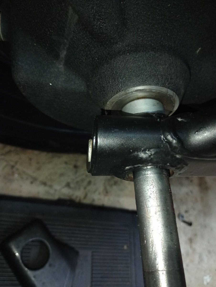

Rear Wheel Spacers and Washers - Rookie Mistake
WDGUZZI replied to WDGUZZI's topic in Technical Topics
Thank you Audiomick and Phil! And big thanks for that workshop manual. I only had an owners manual. -

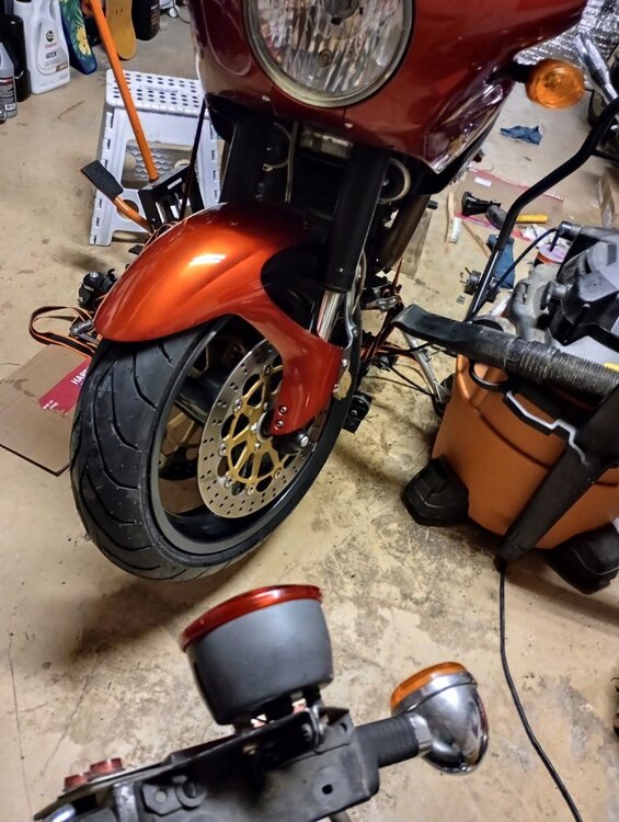

After remounting my 2002 LeMans front wheel with its new Dunlop Roadsmart 4 (please see picture for proof) and feeling like an ace mechanic for how easily it went on, I have been floundering with getting the rear wheel back on. I've reviewed the little line drawing in the owners manual and threads on this forum, and am convinced that the spacer I have on the right side of the bike between the thin flat wide washer and the swingarm should really go inside the hub assembly, between the rear end housing and the wheel where the splines engage. If this is correct, then is there really just the very thin wide washer between the right wheel bearing and the right inner side of the swingarm? Thanks for any advice on this!

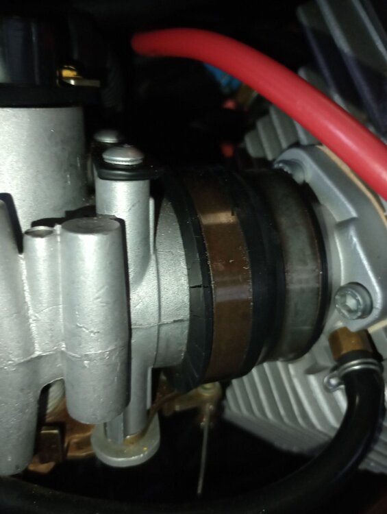

Now that my auction-find 2002 LeMans is running (after replacing the fuel pump and a bad relay and thanks to the guidance of those on this forum), I find that it seems to be running lean. The rubber connections (I'm not even sure what to call them) between the throttle body and intake are poorly fitted, hard, and cracked. I'd like to purchase new ones, but wanted to find out if there was a preferred source for these. I can check with the regular Guzzi vendors, but thought there might be A Guy (like I found there was for relays) that can supply them. Thank you! BTW, I was unfamiliar with M4 exhaust systems but love the sound of their slip-on's on this bike. They allow all the right sounds to come through but are overall surprisingly quiet.
