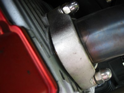

  5. In Germany A LOT of V11 owners with the front crossover had the same problem with the header pipes. Me too (after 6000 Km):

    :!: Here in Germany some V11 Riders have cracks in their exhaust tubes. I our german V11 Forum we came to the conclusion that this could be caused by front crossovers which were tightend too firmly.
