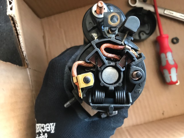

Got the starter motor off and opened. To my untrained eye nothing looks wrong. It actually looks nice and clean. Should I start opening it more? -

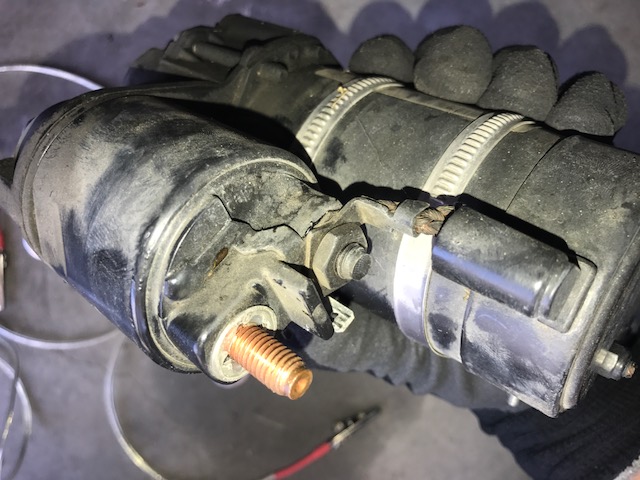

I appreciate all the advice. I am going to pull the starter. I haven't done it before so if there are any special instructions on how to approach that I'd appreciate it. Looked on youtube for a video but haven't seen anything helpful as a DIY on how to remove the starter and where to start with opening it up. I have to travel to Boston for the week so will have to come back to this project when I get back. -

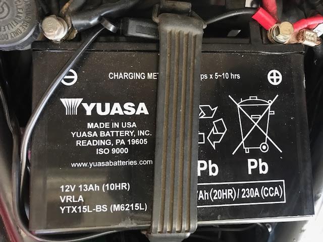

Got it back together but it still does not start. I still hear a single click at the starter but doesn't turn the engine. The battery voltage has me really confused. After charging it with a new charger designed for AGM batteries it reads 14.3v across the leads while its charging. 13.3v when fully charged and no charger attached to the leads. Then after trying to start, it reads 12.2v I attached a battery tender wifi device that tells me the status of the battery and it reads anywhere from 80% charged to 100%charged in a matter of minutes. I plan on removing this device at it seems useless. I just put it on yesterday for the first time to see if it gave any meaningful information. This is a less than 6month old battery and has been maintained with a battery tender the whole time I've had it. Which I'm learning now is not the best approach for an AGM battery. 1. Is this battery a problem? Yuasa 12v 13aH (10hr) VRLA YTX15L-BS (M6215L) 2. Can you give instructions on locating and testing the start relay 30? 3. What would you recommend trying next to figure out why it won't start? 4. Can anyone list all the ground contacts that need to be cleaned (where they are usually located and what methods you use to clean a ground contact)? Relays were all recently updated. Ignition is clean and lubed with fresh vaseline. Battery is new but not sure what to make of the voltage readings I'm getting. I have not put vaseline on the battery leads yet so will do that next. -
