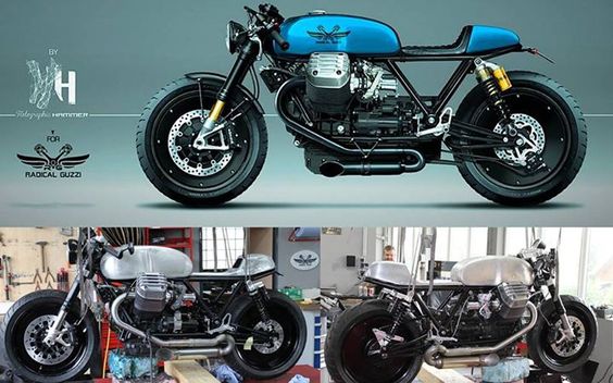

For a mere 49K euro you could have this custom German Guzzi. Ultra rare for sure....made to order. Radical Guzzi Ristretto with 1400cc engine. This has to be the most beautiful guzzi ever. www.radicalguzzi.com
