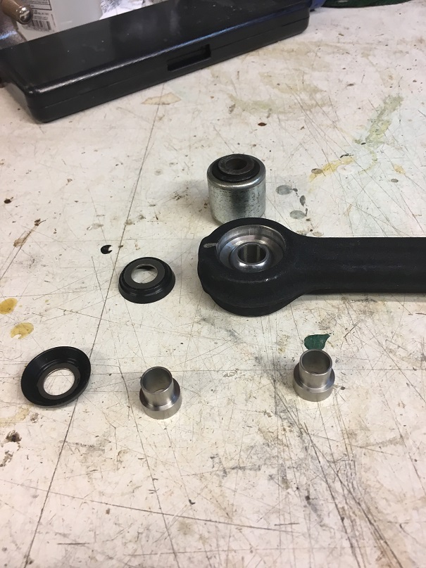

Here's a picture of the reaction rod with the spherical bearing pressed in and the spacers and seals nearby. The old bushing is behind the rod.

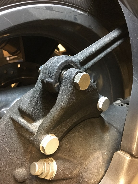

The reaction rod that attaches to the bevel box and the frame has rubber and steel bushings pressed into each end at the factory. They can wear out and create unwanted movement of the bevel box and slop in the drive train. Replacement bushings are not available from Moto Guzzi, and I was unable to find replacements anywhere else. I did find some spherical bearings that could be pressed into the reaction rod, but since they are thinner than the bushings they replaced and they have a larger ID I needed to have a set of custom made spacers made. Once those were done I put everything together and it seems to work just as it should. I attached a drawing with specs for the custom spacers and McMaster-Carr part numbers for the bearings and seals. I'll post a few pics in another post. MOTO GUZZI V11 REACTION ROD WITH SPHERICAL BEARINGS.PDF

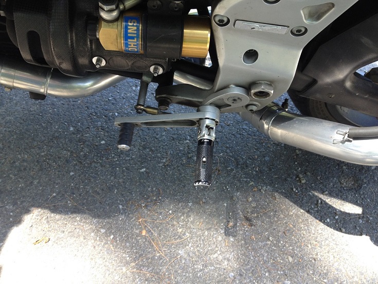

I've used the Motobits setup for many years now. It works well and I still really like it. Just like the stock setup it needs to be disassembled, cleaned and lubed every once in a while. I wasn't crazy about the non-folding footpegs so added folding pegs and put rubber covered tips on the shifter and brake levers. I haven't had any problems at all with the long sleeved bolt itself, but you should be aware that it puts much more torque on the tip of the stock shift link that attaches to the shifter shaft than the stock linkage does. Other members here (Slug?) have had that part break at the first bend above the tip. I checked mine out a few years ago and it was starting to crack so I put a new one on then had the old one welded with bracing to beef up the tip. Here's a pic of my shifter side before beefing up the stock shift link.
