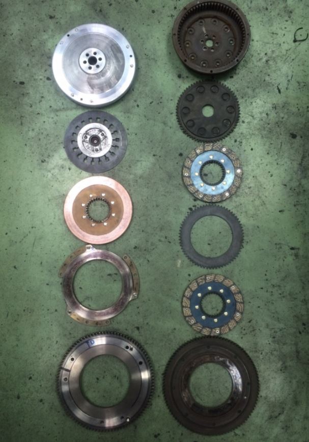

Dear all, KG hit the problem on the head. The friction plate side with raised lip has to face rearwards, and not forward. With hindsight, it is clear that the raised lip (raised about 5mm) would contact the pressure plate and has the effect of reducing the reach of the push rod correspondingly. Having gone through the exercise, I must say that I have learnt a lot from you guys, and I wish to thank all of your for the help. Will post a pic of the running bike when I have time to put it together. Thank you. Andy -

You mean the raised portion points to the front of the bike? if so that is what I did. Andy Your friction plate(s) in photo post #8 is backwards. Turn raised side pointing to gearbox like my photo in post #20 -KG- KG, You are right, the raised surface of the friction plate I have been installing frontwards. I will try facing backwards and see what happens. Andy -

To complete the picture, here's a pic of the hub removed from the Scura's single plate system: This is a pic of the twin disc hub from the internet (which I have mounted into the gearbox): Compared the thickness with the twin plate hub now mounted in my gear box; extra thickness necessary cos of the 2-plate system: -

Dear Docc, Yes, the intended replacement is from a single plate clutch system (left) to a twin disc system (right). The parts (actual) can be compared: The pushrod is from the Scura, the hub is from Gutsibits. This is the hub with pushrod installed: This is the bowl or cup that Gutsibits also supplied: The Scura system has a pushrod recess built into the pressure plate. Rather elegant. Reverse of the cup, if that is material. -

Dear all, I am really at my wits' end here. Removed the gearbox and the springs all seemed to be properly seated. I even replaced the friction plates with the "thinner" 7.5mm ones from MG Cycles, no luck. There is no complete neutral when the clutch lever is pulled in, such that I can rotate the rear wheel freely. Some pics are attached. Can anyone tell if the flywheel is from a 5-speed or 6-speed? Does it even matter? Took out the pushrod to make sure that I am not missing any washers etc. What I will do now is to measure the length of the pushrod actuated extension when the clutch lever is pulled in against the compression of the springs in a vice. This is to see if there is a possibility that the pushrod was not being actuated sufficiently to compress the springs and disengage the friction plates. Am I correct to say that the pushrod is in contact with the pressure plate "bowl" by the fact that there is tension in the clutch lever? Thanks for the views, guys, keep the advice coming. Andy -

Dear all, I have a Scura. Yes, the one that is prone to a grenading clutch. So I decided to convert to a twin-clutch. Got a used set from Gutsibits. I installed the clutch. It came with new springs (the 5-ring ones) that are stronger. I also have new SD friction plates and intermittent plate. After reinstallation, the clutch does not disengage. There is tension in the clutch lever, which means that the pressure plate is being actuated. So, what happened after was: 1. I changed to the original softer (6-ring) springs. Softer pull on the clutch lever, no disengagement still. 2. I read that the SD friction plates are thicker, so I machined skimmed it down to under the 8mm thickness of the stock plates. No disengagement. 3. Checked that the intermittent plate is flat and not warped. 4. I have bled and changed the fluid out in the clutch master cylinder too. The clutch still does not disengage. I am at my wits end. Contemplating doing a Non Destructive Testing on my aluminium flywheel and then reinstalling the original single plater. Or look or CNC a steel flywheel. Views, gents? Andy
