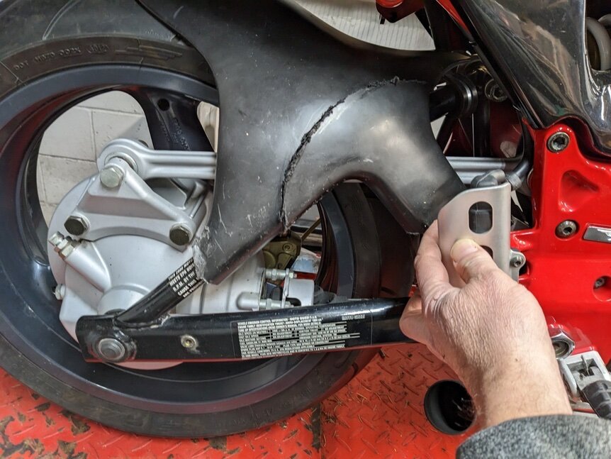

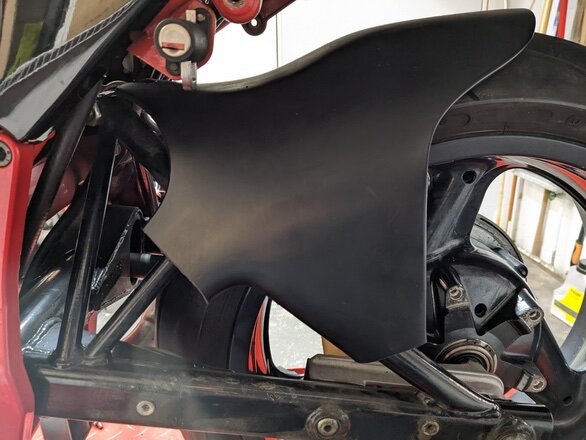

Thanks everyone for the positive comments. If anyone decides to tackle this, my advice is to draw the cuts you want to make, take your time and leave generous excess to trim down. It’s not a lot of work, but it matters to get it looking how you want!
This! Never understood why Moto Guzzi decided to cover all that cool swing arm tubing. But I still wanted a nice hugger. Turns out there is a pretty nice hugger waiting to be let out of its abs cage. It was a little scary when I did it on my Silver bike, but it came out perfect. So I checked my old photos and broke out the dremel!
The pegs really fit perfectly and don’t seem to be modified in any way, but no guarantees!
I didn’t install them, but I think they may be Ducati pegs. Early monster?
The wheel is the later 5.5 x 17 with a 180/55/17 Michelin Pilot. The powder coat was done by IPC in Rockaway NJ. Cleaning up the powder coat masking at the cushdrive interface was time consuming. It’s completely hidden, but the cushdrive sealing o-ring rides there. 83 degree valve stems were installed, new bearings were installed (and the rear spacer shimmed out to 113 mm, thanks docc!). I removed the stock fender / swingarm cover / hugger and carefully, incrementally, cut it, test fit and trimmed until I was happy. I had also done this on my Silver V11. I like the look. I have some pics of a few cuts but reducing the file size is tricky for me, I don’t know which apps I can trust with that access to my phone! Anyway, it’s held in place with standard rubber protected pipe clamps from a local hardware store. The Rivet Nuts in the swingarm that hold the stock fender hardware on were removed by inserting a ~20mm long, 5mm thread button head screw 2 turns in and carefully hammering on the button head until it allowed easy extraction with some needle nose pliers. 10mm black plastic flush furniture hole plugs press into the empty holes. The information decals on the swing arm were removed with a heat gun. Also in the photo is a 500 lbs Eibach spring on the stock Sachs shock. I need to send my Penske out for a revalve, as funds allow.
