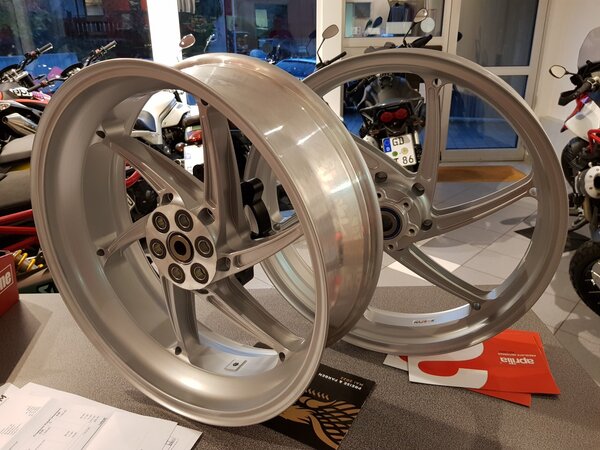

I went ahead and installed one bearing so that I could measure the length that my spacer would need to be. Sure enough, it needs to be .014 inches longer to not bind. So my new bearings would have had a shortened life. I’ll get some .015 shim stock and make a shim.
Mine measures 4.428 inches, or roughly 112.5 mm. I have a 0.8 mm bearing spacer to bring it to 113.3 mm. I believe that should work, what do you think? Too long?
Unknown mileage, it wasn’t the original wheel. It was the brake disc side that went. If I recall correctly, I thought there was something weird going on the rear brake at the end of a 500 mile trip. I jacked it up and when I spun the wheel it was immediately obvious.
Thanks doc, Will do! I made sure the front spacer was ‘proud’ of the bearing bore inner face before tapping the second bearing in place. I know the rear bearing spacers are the more troublesome of the two. I had a rear go in my old V11, back in 2009-ish.
I replaced my stock (tire) valve stems with 83 degree angled stems, replaced the front wheel bearings and disc hardware (now titanium). Rear wheel bearings and disc hardware coming up next.
Finally installed my Lucky Phil Extender. It really looks nice and fits perfectly. Nice work Chuck, and nice design Phil! Can’t try it any time soon, because the rims are off for bearings and such, and the rear shock is getting swapped.
Okay, fronts measure M8 x 1.25 and are 20 mm long. Rears are also M8 x 1.25, with a 20 mm long threaded portion, then a 4.5 mm long shoulder that is 10 mm in diameter. If that jogs anyone’s memory! Easier to just contact Race Ti? I will be forced to buy more titanium if I go that route……….you know, to err, justify the shipping.

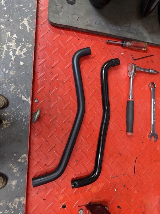

I replaced the crankcase vent tube. It was disintegrating on each end and leaking bad enough to let me watch the hot oil run down the right side of the crankcase and onto the hot exhaust. Smoky. I had done it on my silver bike and recalled that it was a bit of a struggle, but this time, oddly, I enjoyed the struggle.
