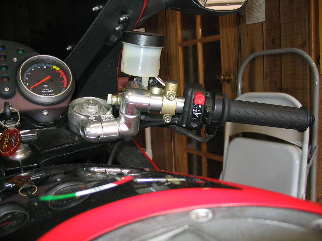

  1. By reclocking, I mean changing their rotational position. Using your 14mm open end, loosen the banjo bolt just enough to allow it to turn, but not enough to allow any brake fluid to escape or air to get in. Then tighten it up again. -Jack
  2. I was thinking that I would feel a lot more vibration with these bars, but that is not the case really. There's a very slight increase in vibs, but I was planning on switching to those ProGrip gels anyway. They more than make up the difference, certainly compares to the thin stock grips. >>wiring The only thing I had to change was the wire bundle for the starter switch cluster, which I routed behind the fork tube. It was too short to leave it in front where it formerly ran along with the throttle cables. Other than re-clocking the banjo bolts on the clutch and brake master cylinders, that's all I changed. There's a little logo on the Tomaselli's that looks like a big M with a very small T above it. The same logo is on the stock clipons that I took off. Is it possible that Tomaselli makes the factoery ones? -Jack
  3. After being absent for nearly four years (long boring story), I finally got my Tomaselli adjustables put on. These items have a tremendous range of adjustability and are really well made. I have mounted mine so that the bars are about an inch higher and 2 inches further back. The result is a more upright riding position which suits my needs a lot more than the forward lean of the originals. Anyone know where these might still be available? -Jack More pics -Jack More pics -Jack

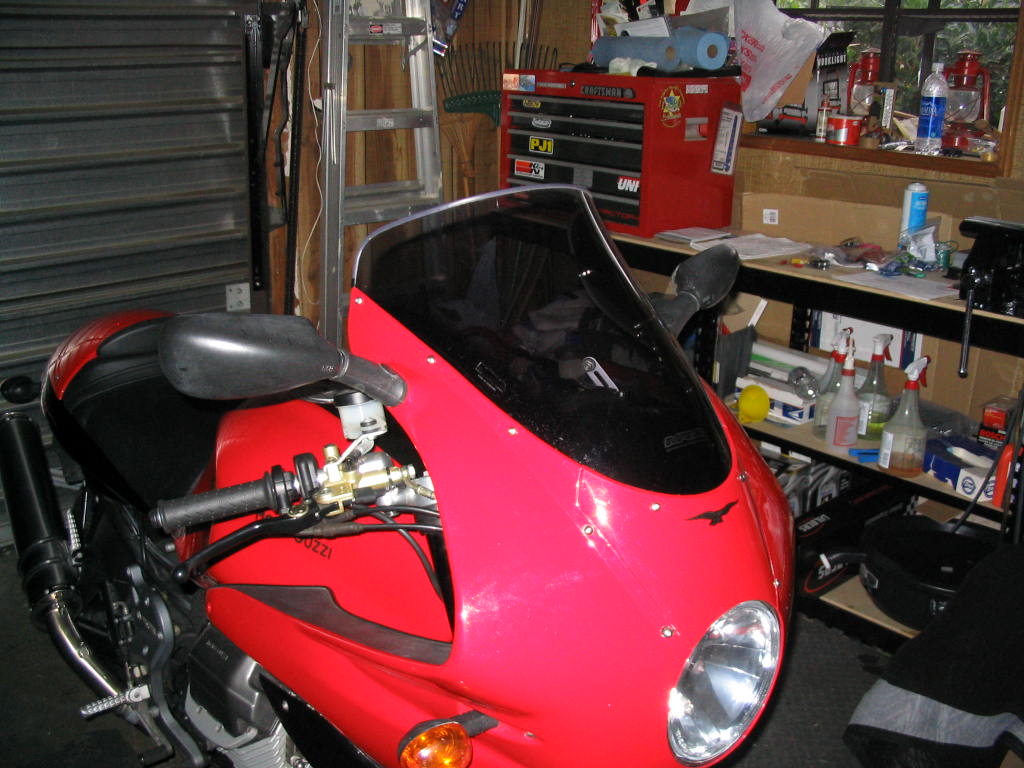

  4. They make an extremely high-quality product. It fit perfectly, looks great, and provides a bigger pocket of relatively still air. -Jack

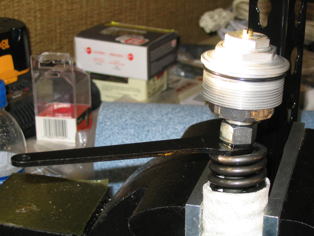

  13. For Rusty Bucket: Here's a look at the preload adjuster inside my forks (2004 Le Mans) -Jack

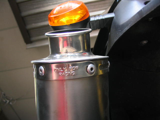

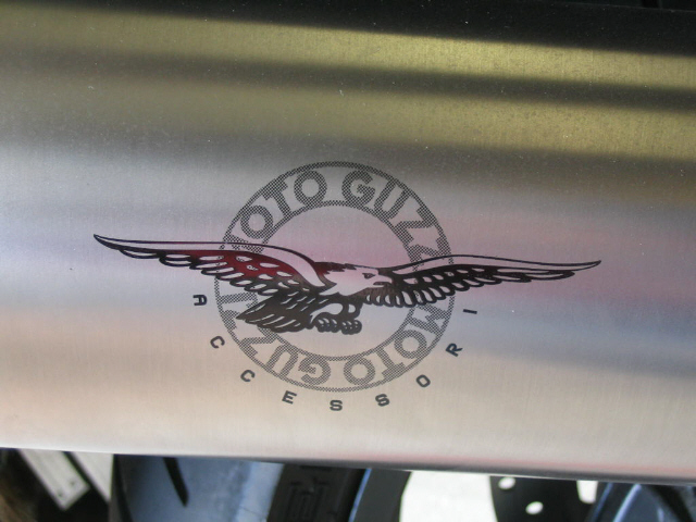

  16. >>My ti pipes have "for racing only" stamped on the underside of the st/steel band. So does mine, but meesathinkin that it should not be a problem because it took me a little while to find it. Plus there's that prominent factory logo on the outside. If it turns out to be a problem, I've got my stock ones (izza 2004) that I'll loan you. -Jack

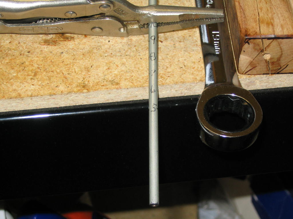

  25. >>If you need to draw off excess oil, you can use y'er brake tube and/or tubing. That's the whole point of the tubing/siphon procedure. Plus, you get very repeatable levels. Motion Pro sells a fork fluid level setting device that I have seen used in a lot of shops. My version is just a lot less expensive. >>Excessive rebound dampin' can cause the suspension to "pack" and thus become harsh. I could not agree more. >>FWIW: I went with 5w fluid in my set, and they were still harsh. That's a pretty revealing fact, which is why I may be looking for the link to that German guy with all of the forks. I was beginning to think that I have some kind of mechanical binding going on, but after reading about the 5wt still being too harsh, that might not be the case. -Jack (still bounding down the roadway...) Here's how the siphon thingy works. Just pretend that the roll of paper towels is your fork tube.
