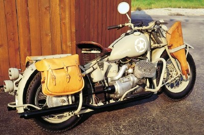

quote name='roberto tenni' date='Feb 27 2008, 07:42 AM' post='138649'] My favorite Harley would have to have a 90 degree transverse mounted v twin... hang on, that's... Ok, how about this one???...err Indian [
