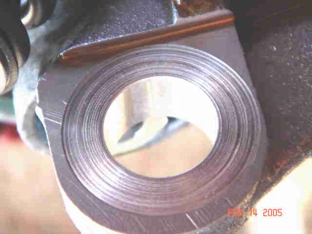

Guzziology gives the order. Round heads dont have the bottom brass shim (the one I have problems with) and square heads do. Also the round heads have the spring next to the rocker while the square heads have the bronze washer next to the rocker then the spring. Steel Shim Spring Bronze Shim Rocker Bronze Shim Is the order he gives for Square heads. He states in his book that the order is not really clearly specified anywhere else. Again, I put it together, rode it for 5 minutes, let the bike sit for several days and took them apart today. There is oil oozing from the pores in the rocker assembly and everywere up top. I could not see any particular way that bottom shim gets any oil except by plain old migration. The oil races seem to be lubricating the pivot on the rocker arms. Unless someone convinces me otherwise, I think I am going to put this one to bed for now...If that wear were up next to the spring or rocker arm itself, I would be more worried. Scott
I did say before, but the stack from Top to Bottom is Steel Shim Spring Brass Shim Rocker Brass Shim I actually found 1 out of 4 that the steel and brass shim were mixed up, but only 1 and it didnt seem to wear any differently from the others. Scott
I decided to pull one apart and take some photos to share with any of you who are interested. Notice the circular abraison pattern on the rocker carrier and the matching face of the brass shim. This is only on the one face of the shim and carrier mating surface. It ONLY appears on the lower shim and it appears on ALL FOUR of them. The rest of the rocker parts, shims and surfaces look good. Top Shim on the left, Bottom (worn) Shim on the right. Scott
