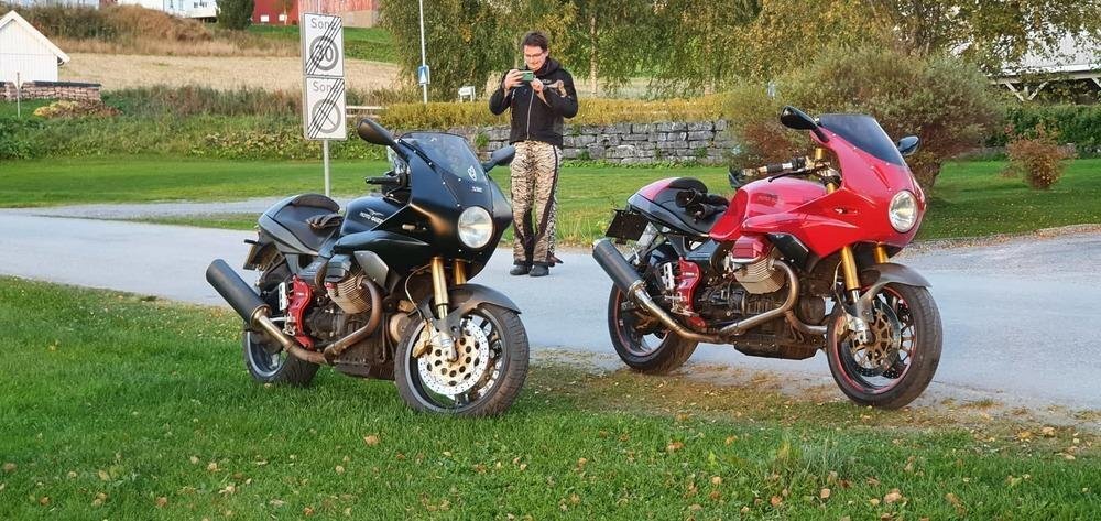

  3. Well, I have Le Mans Rosso Corsa, my son has a Scura, and I've sold a Rosso Mandello to a guy up North. So there are at least three that he does not own...

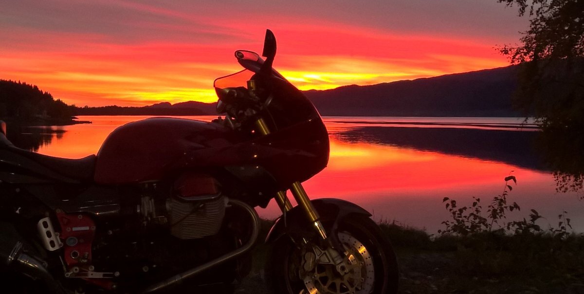

  6. Rosso Corsa in Norwegian sunset.
