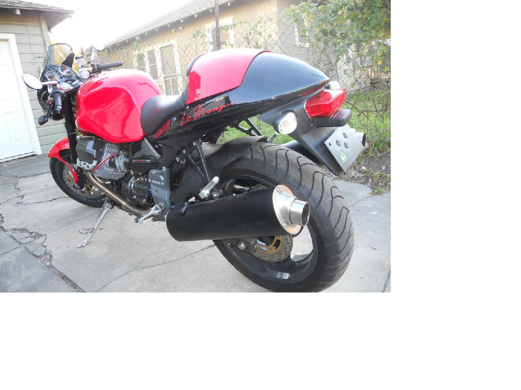

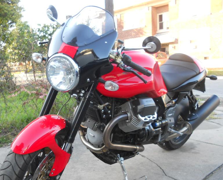

  20. The only opportunity this site gives me to post pictures is when i start a new topic, so I did that. most of the pictues i have are too big to upload but i posted the same shot i use as my profile pic plus one from the rear under the title 'My bike's gorgeous but a Frankenstein of year models'
  21. Looked like a Cafe Sport or Ballabio, but hunting for parts reveals that her VIN is from a Nero Corsa and her front end is two years older. Maybe her tail section is not original either. What is she?
