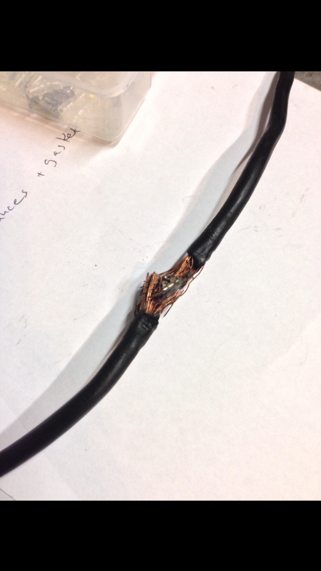

  4. Found the attachment point right behind the seat lock, was actually pretty easy to find. Holy Moses is it in sh*te condition. Didn't have long enough wire to replace it tonight, will do it at the end of the week. Just re-wrapped it with fresh electrical tape in the meantime. Bike will be so much happier with a real ground wire.

  7. Anyone have any tips as to how to most easily remove the battery ground wire? What is the minimum amount of stuff that needs to be disassembled in order to get to where it is attached to the bike? I've followed it back to behind the seat lock, where it disappears into a bunch of other stuff. Mine was cut at some point and spliced back together, I want to replace it with a fresh wire tonight. Any suggestions as to how to do this as efficiently as possible wold be greatly appreciated. Thanks!

  13. Had the tank off last night and checked the main battery grounding cable as suggested by Kiwi_Roy, and it has a fat wad of electrical tape in the middle of it, which suggests to me that it was cut at some point and spliced back together. So that's the first thing to fix. I didn't trace it back all the way to where it's mounted, wouldn't be surprised if there were other nasty things back there. The wiring along the frame under the tank for the most part looks ok, I didn't really get into it. Kind of dirty overall. Some weird lines running here and there that don't look like they are part of the stock harness. The battery stacks have three thick main wires on each terminal, and a thin green one on the positive terminal which goes to a cylindrical electrical thing next to the ECU (which I can't find in the manual ,) and on the negative there is a thin red wire which is zip tied to the main harness that goes along the spine, and it then disappears into a rat's nest of other thin red wires. I will investigate these further. Lots of brittle cracked harness, but I didn't notice any exposes wires or much in the way of corrosion (yet...) Not to change the subject, but there was another weird thing I found: what looks like a thin breather hose coming out of the right side intake manifold. It wasn't attached to anything. It does not appear in the workshop manual. When I put the tank back on it annoyed me that it was hanging there. So I (temporarily, pending some explanation) attached it to the tiny little nozzle on the bottom of the "Pressure Adjuster" (section I page 6 of the workshop manual) because that was the only thing nearby that seemed like a logical place for it to go onto. I haven't tested the r/r yet, will do that next, and get deeper into inspecting the wires. I'd like to figure out what those two extra wires are that are running off the battery. There are also some connectors that aren't hooked up to anything. The PO put a LED fender eliminator on the back and LED turn signals on the front and that was done sloppily, with electrical tape splices. Also the side stand switch is broken but still wired into the harness, so that could be a cause for some electrical badness, I'd like to remove it if possible.
