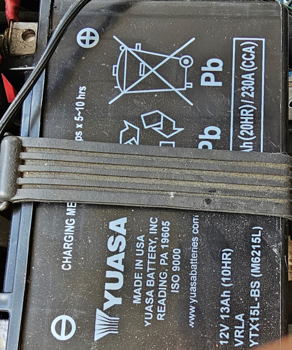

Hey Docc! I was hoping to hear from you. I'm including a picture of the battery in this post. It's pretty old, but it has always been hooked up to a battery tender when not in use.

Thank you for your response. I had it hooked up to a Battery Tender Junior, so maybe it wasn't getting enough juice while it sat.
