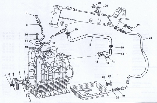

Anyone have an illustration or schematic of the breather system?
This?
Link to comment
Share on other sites
Yes, that, thank you.
So essentially the frame is a large puke can then?
And what the hell just happened to the threads?[/quote)
Yes to the puke can question.
