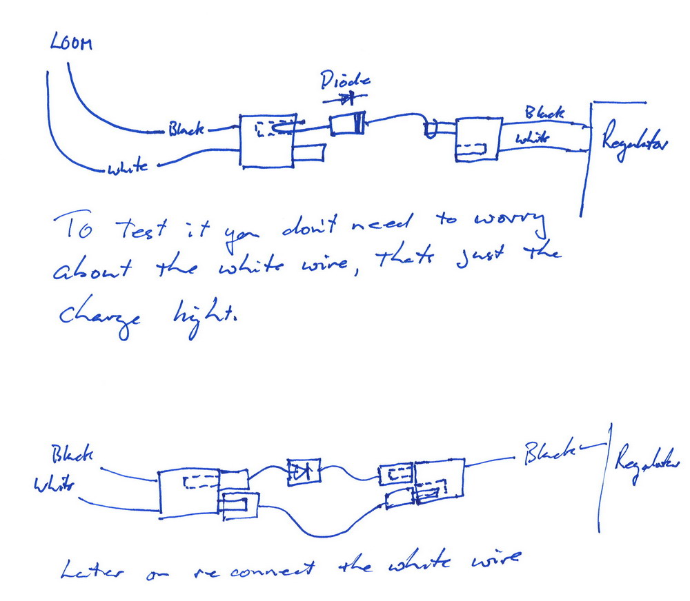

You can boost it up by 0.6 Volts simply by adding a diode in series with the black wire.
To test it unplug the Black/White plug and turn it half a turn so only the white one is connected then take a diode wired to a M/F bullet connector and connect the other two. Something like this.
White-------> >-------White---|regulator|
Black---
- Diode
Sorry, it doesn't display how I want it, I will do a sketch
Black---
- Diode
Thanks for that Roy. I'll give it a try the next time I pull my fairing off.

There is so much miss-information about batteries on the web it's hard to get it straight anymore. You ask about the difference between 13.9 and 14.5. If you look at any reasonable Voltage vs % charge curve 0.6 Volts amounts to about 30% of charge.
The idea of adding a "Trick" diode is just to restore the status quo after adding headlight relays that's all. Luigi was tricking the regulator by dropping voltage between battery and reference wire, adding relays foiled his trick :rolleyes:
Have you checked the diodes in your regulator, not being able to recover sounds a bit like mine when one of the diodes let go.
I think the charging on the V11 is quite good when it's working as it was intended, the alternator certainly has enough capacity.

Sorry Hubert,
As I said there's so much information out there. I'm not saying the author doesn't know what he's talking about I just don't think it applies in our case. Our bikes with Ducati Energia regulators are more like constant Voltage chargers cutting off at 13.8V with the headlight relay 14.4 without, not constant current as per the article. His curves are interesting though, note how the flat part of the curve gets closer to the setpoint as the C/time drops.
I suspect we start out at C/1 and work our way up towards C/20 covering a very wide SOC band.
Battery Curve.pdf
I also suspect these curves are just freehand sketches (which is quite ok) not something that was actually plotted.
You may wonder why my 2 setpoints are different by 0.6 Volts, it just so happens that's the voltage drop I measured on my bike
from battery + to the black wire others will be a little different, some more, some less.
