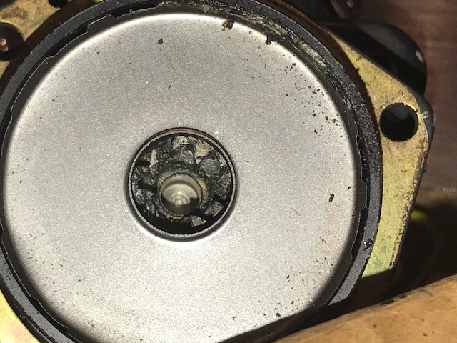

docc Posted May 29, 2017 Share Posted May 29, 2017 I thought you could pull the starter apart by removing the two nuts on the very back of the can, then slide the can off? Link to comment Share on other sites More sharing options...
plexiform Posted May 29, 2017 Author Share Posted May 29, 2017 I'll try it again. I can get it open that way but I didn't see a way to pull everything out from that end. Link to comment Share on other sites More sharing options...
plexiform Posted May 29, 2017 Author Share Posted May 29, 2017 ok so how do you pull the rest of it out? Link to comment Share on other sites More sharing options...

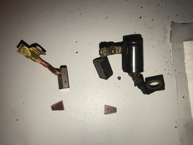

plexiform Posted June 4, 2017 Author Share Posted June 4, 2017 So the magnets look good. Link to comment Share on other sites More sharing options...

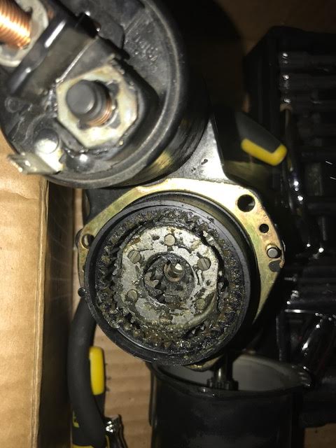

plexiform Posted June 4, 2017 Author Share Posted June 4, 2017 Lots of gunk in there....is it worth opening it up further or just get a new starter? What are your thoughts on this Mitsubishi starter that is being touted as more reliable and more easy to repair if something goes wrong? Is it even an option for the V11? Scroll to bottom of the link below. http://www.motoelekt.com/starter.htm Link to comment Share on other sites More sharing options...
docc Posted June 4, 2017 Share Posted June 4, 2017 They're saying the NipponDenso draws 80 amps, and the BMW Bosch 120 amps? I don't recall our Valeo drawing anything like that, even at inrush? BTW, Is that tarmac and gravel packed around your starter shaft? Seems that could make for some excessive *friction*/ draw . . . Link to comment Share on other sites More sharing options...
plexiform Posted June 5, 2017 Author Share Posted June 5, 2017 Will clean it up and see if that makes a difference. Link to comment Share on other sites More sharing options...
guzzi323 Posted June 5, 2017 Share Posted June 5, 2017 I put one of these after numerous problems with the stock Valeo. It's been trouble free for years. What are your thoughts on this Mitsubishi starter that is being touted as more reliable and more easy to repair if something goes wrong? Is it even an option for the V11? Scroll to bottom of the link below. http://www.motoelekt.com/starter.htm 1 Link to comment Share on other sites More sharing options...
Kiwi_Roy Posted June 5, 2017 Share Posted June 5, 2017 Mitsubishi certainly have a good reputation. But your starter looks ok from what I can see Refresh that grease in the planetary gearbox then put it back together Test it out with 12 Volts. If you don't have a vice just put it on the floor and put your foot on itclip the negative jumper cable to the flange then touch the positive to the short jumper between solenoid and motor. That's applying Voltage directly across the motor. If that works next clip the positive lead to the solenoid where the Guzzi battery normally connects. With a short length of wire jumper between the solenoid trigger terminal and Positive. Link to comment Share on other sites More sharing options...
