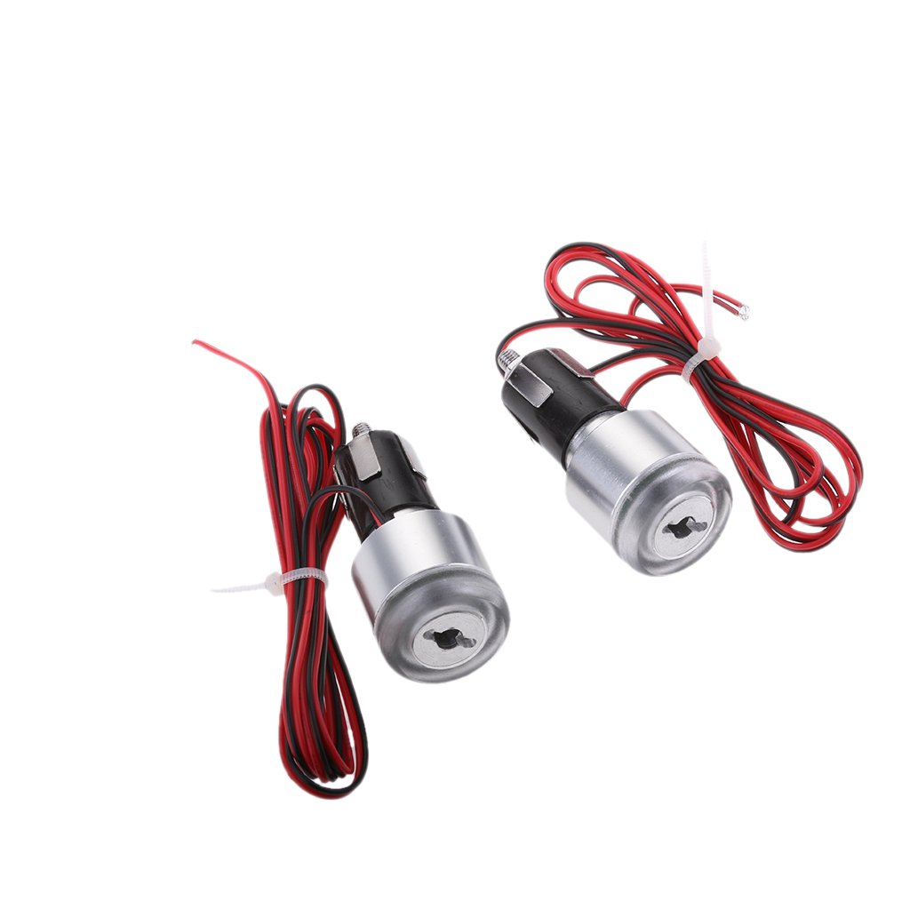

swooshdave Posted November 4, 2017 Share Posted November 4, 2017 Has anyone ran wires inside the handlebars and how did you do it? I'm thinking about bar end turn signals and want to hide the wiring. Before I get too crazy I need to ride the bike without the bar end weights and see how much difference they make. I may need to shove some lead tube up the bars first. https://www.amazon.com/dp/B072JXY9HS/_encoding=UTF8?coliid=IGWV67QR3RPDC&colid=26Y5AVMGX9WC6 Link to comment Share on other sites More sharing options...
