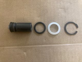

Revilo Posted August 4 Posted August 4 Hi Folks. I've been trying to get my 2003 Cafe Sport back on the road after it was stolen and recovered...now some time ago! Both handlebar controls were quite mangled! I have sorted most of the issues but I haven't found a solution to getting the Clutch and Brake maters right. The main problem is that Brembo seal kits don't appear to be available anymore. On the Clutch side the Piston and seals themselves seem OK but the dust cover is damaged. On the Brake side, the bore, piston (16mm dia) and pressure seal seem in good condition, but the O ring seems to be slightly too big ( ie. about 16.5mm internal dia. Does this seem wrong? It doesn't sit neatly in the machining within the bore). The Dust cover is also damaged. Does anybody have any idea where I could find these parts, or if not, have encountered the same problem and worked out an alternative to the original set up? If I am correct in not being able to buy kits, I imagine a few of us will have have problems keeping these components serviceable. I'd appreciate any thoughts. Best wishes Revilo
Lucky Phil Posted August 4 Posted August 4 13 hours ago, Revilo said: Hi Folks. I've been trying to get my 2003 Cafe Sport back on the road after it was stolen and recovered...now some time ago! Both handlebar controls were quite mangled! I have sorted most of the issues but I haven't found a solution to getting the Clutch and Brake maters right. The main problem is that Brembo seal kits don't appear to be available anymore. On the Clutch side the Piston and seals themselves seem OK but the dust cover is damaged. On the Brake side, the bore, piston (16mm dia) and pressure seal seem in good condition, but the O ring seems to be slightly too big ( ie. about 16.5mm internal dia. Does this seem wrong? It doesn't sit neatly in the machining within the bore). The Dust cover is also damaged. Does anybody have any idea where I could find these parts, or if not, have encountered the same problem and worked out an alternative to the original set up? If I am correct in not being able to buy kits, I imagine a few of us will have have problems keeping these components serviceable. I'd appreciate any thoughts. Best wishes Revilo Save yourself a headache and just buy new master cylinders. You'll probably get both for around 200USD brand new. Phil 2
docc Posted August 4 Posted August 4 46 minutes ago, Lucky Phil said: Save yourself a headache and just buy new master cylinders. You'll probably get both for around 200USD brand new. Phil @Lucky Phil just posted these links to front brake master cylinders in another thread. [I have "split" those posts here and they are seen as the first posts in this thread, now.] I have rebuilt my clutch master twice. The 12mm kit is available as Brembo part number: . OPPracing may be a resource for the brake parts, as well. https://www.oppracing.com/product_display/202872-brembo-oe-spare-part-master-cylinder-brake-12mm-seal-set-for-front-master-110436292/#&gid=1&pid=103200

Revilo Posted August 11 Posted August 11 Thanks team for your suggestions around the brake master kit. I've been trying to keep costs down but it is beginning to look like a fully new master will be my only option. I'll report back. Thanks once again for sharing your experience. ..and thanks to Docc for keeping a semblance of order around here. 1
docc Posted August 11 Posted August 11 3 hours ago, Revilo said: Thanks team for your suggestions around the brake master kit. I've been trying to keep costs down but it is beginning to look like a fully new master will be my only option. I'll report back. Thanks once again for sharing your experience. ..and thanks to Docc for keeping a semblance of order around here. I appreciate the complimentary verisimilitude! While the 12mm master cylinder rebuild kit (V11 clutch) appears to remain available, I am still dismayed that no one can find the 16mm "seal kit" for the front brake.

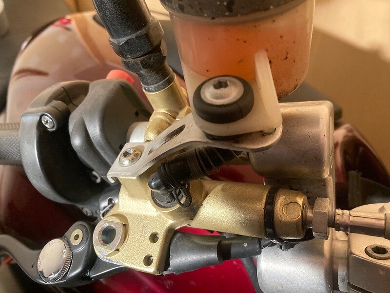

skibum69 Posted August 14 Author Posted August 14 (edited) Back again. Phil you sent me the link for 2 different master cylinders. I take it from those links that mine is the 16mm version? I wouldn't know how to even check that. I only ask because I stupidly looked at a 13mm on one of those websites. Edited August 14 by skibum69
