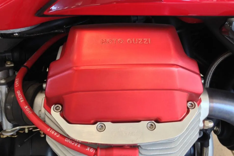

best place to get red valve covers & matte grey frame plates?
SierraTango replied to fastaussie's topic in 24/7 V11
I apologize if I was unclear in my reply. I was suggesting that the OP take the closeup picture of the valve cover in post #1 to a experienced powder coating shop to see how close they could match it. I was not suggesting he take the picture of my bike to do so. I live in a smallish town and there are two excellent shops that do this type of work close by. I don't know why you found this funny? Please explain. -
