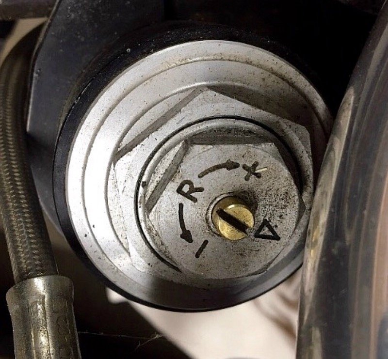

Stewgnu, can you post the link to those replacement cartidges you just installed ?
Have you had a chance to try them out properly ? I heard it's been a wet Autumn.
Is this the syle of fork cap you have ?

Hey up Nobleswood, yes they are the original caps I had.
