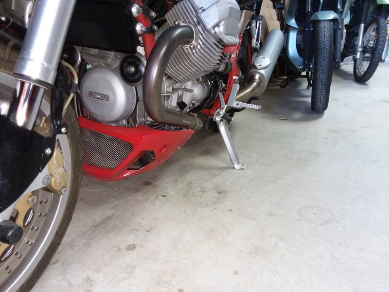

This is what our Rube Goldberg V11 sidestand is for: to make the shifter seem positively simple and sensible. :blink:
I suppose, in all fairness, rearset footpegs have always necessitated creative shift mechanisms . . .
Link to post
Share on other sites
 Truer words..... as they say . I had to cover both on mine with a Panigale sidestand  and extended pegs and shifter so I would fit comfortably. All reversible if need be
 Paul B:bier:
