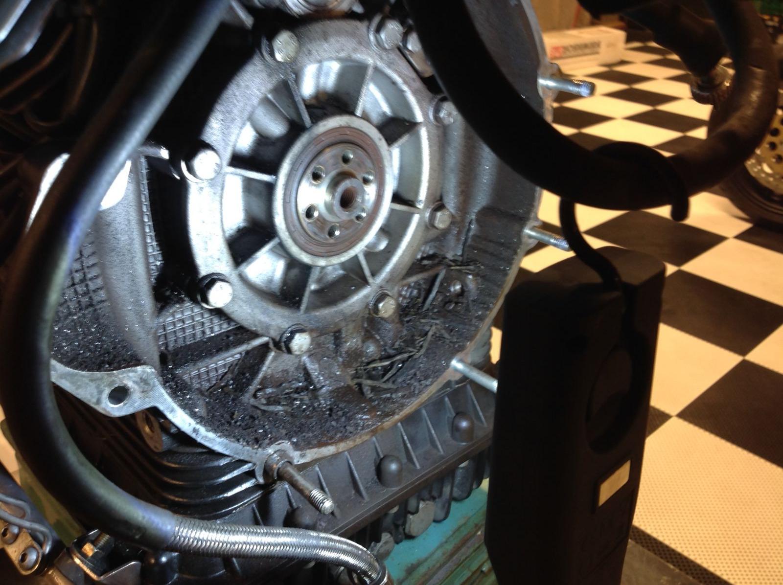

docc Posted July 15, 2017 Posted July 15, 2017 As many of you know, my wishful thinking that my clutch slave had failed burst like a bubble. Â A couple other members have reported sticking clutch plates. In one case, the friction material came off one of the plates and gummed up the input shaft. Â grossohc, what did you find when you got into the clutch? Â ["The problem was the plates sticking on the flywheel. Anyway the only thing I didn't buy for this job was a new clutch line. So just dive in there and have fun Docc."], posted by grossohc in Andy York's "Clutch Slave" thread: http://www.v11lemans.com/forums/index.php?showtopic=19794&p=222978

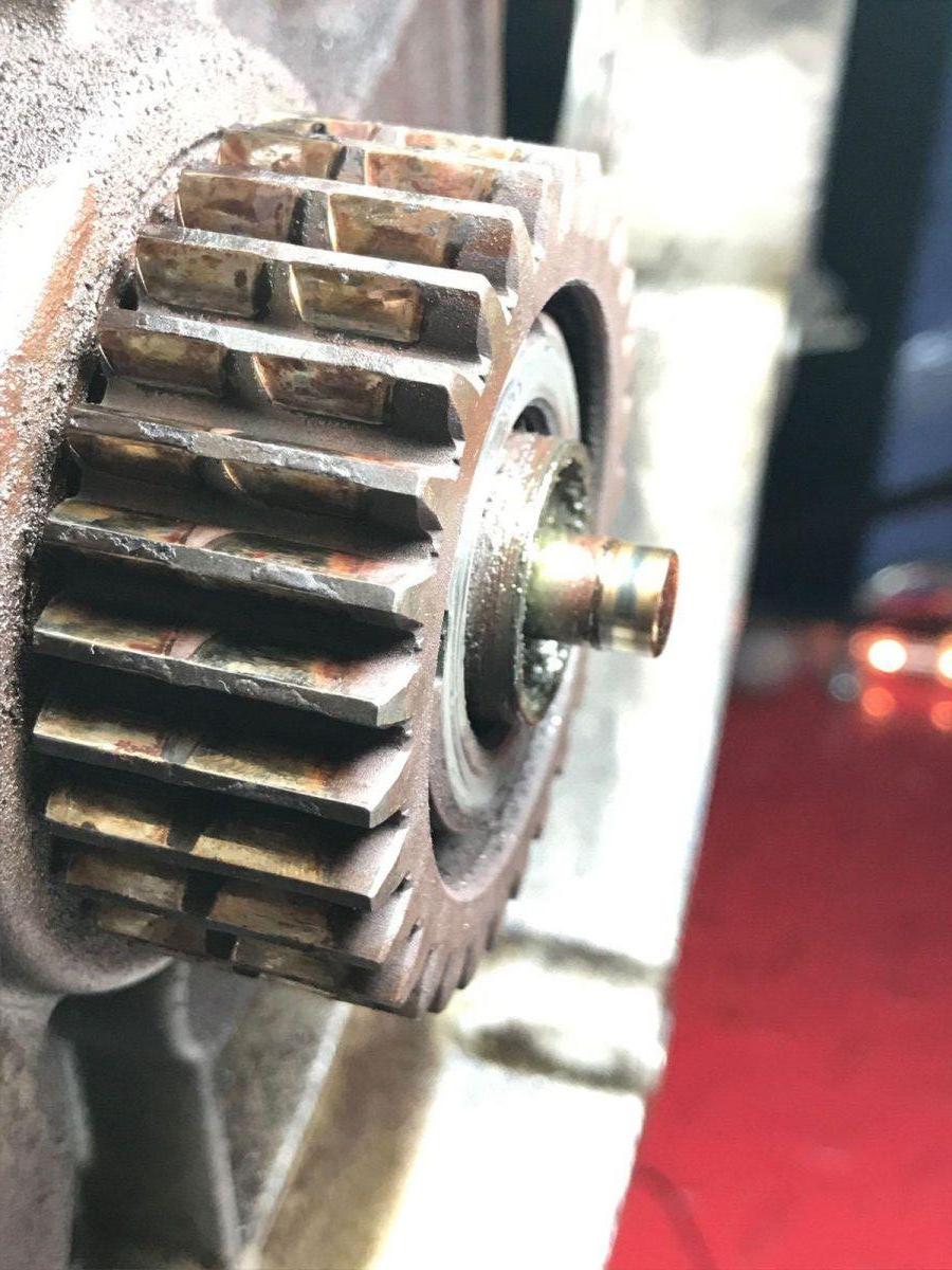

docc Posted July 15, 2017 Author Posted July 15, 2017 Is it this piece? And, Chuck, is it this (input "shaft" = input "hub?")        [ABOVE: Tomchri's input hub / "clutch gear"]
Tomchri Posted July 15, 2017 Posted July 15, 2017 docc I found a guy over here making the tool to take off the gear hub, you need one. I bought one about 85-90$ tom
Scud Posted July 15, 2017 Posted July 15, 2017 I'm not sure that input hub has to come off. Looks pretty good to me.

docc Posted July 15, 2017 Author Posted July 15, 2017 Soooo, I haven't got that far yet! That is an image Tomchri sent me. Â So, grossohc, which part did you have the excessive wear?
docc Posted July 16, 2017 Author Posted July 16, 2017 My "clutch gear" 04211600 Â Â Looks pretty knackered. Enough to stop the clutch from engaging? Â docc's 76,500 mile input
andy york Posted July 16, 2017 Posted July 16, 2017 Thats a nasty looking mess right there. I don't think it is enough to keep the clutch from engaging. It might require some fancy lever action but it should still function. I have the hub wrench if you need it ....among other thingsÂ
docc Posted July 16, 2017 Author Posted July 16, 2017 I was just trying to wrap my mind around the *three* special tools in the Workshop Manual to R&R the clutch.  Gonna stop wrenching for tonight and apply biscuits&bacon in the morning at Lieper's Fork . . .  Still looking to lay eyes on the world's worst V11 flywheel teeth . . .  At this point, Tomchri's clutch failure is not what I am seeing . . . Tomchri's detached friction material 1
luhbo Posted July 16, 2017 Posted July 16, 2017 What is this muddy mess sticking to the engine side? That's your engine, or just another worst possible internet find?
docc Posted July 16, 2017 Author Posted July 16, 2017 The images in Post#3 and the "muddy mess" in Post#11 are from Tomchri. The mess is one of the friction surfaces of a clutch plate.  Image in Post#9 is the input hub on my Sport that I've held the clutch in at stops all these years. This gearbox was replaced under warranty at 27,000 mils, so has about 76,500 miles/ 123.000 km.  [i added captions to the images.]
