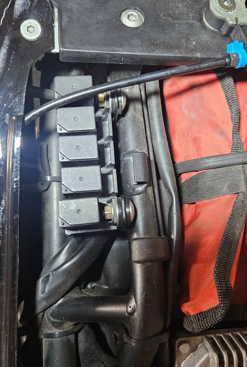

  10. I did just try swapping #4 with #5... no priming of the fuel pump but i did noticed a louder click coming from the relay.
  11. This is what I have in every position. I'm assuming #5 position is the one most towards the rear of the bike?
  12. Do you have a good source for spare relays? I hear the Omron ones are unavailable. MG Cycle perhaps?
