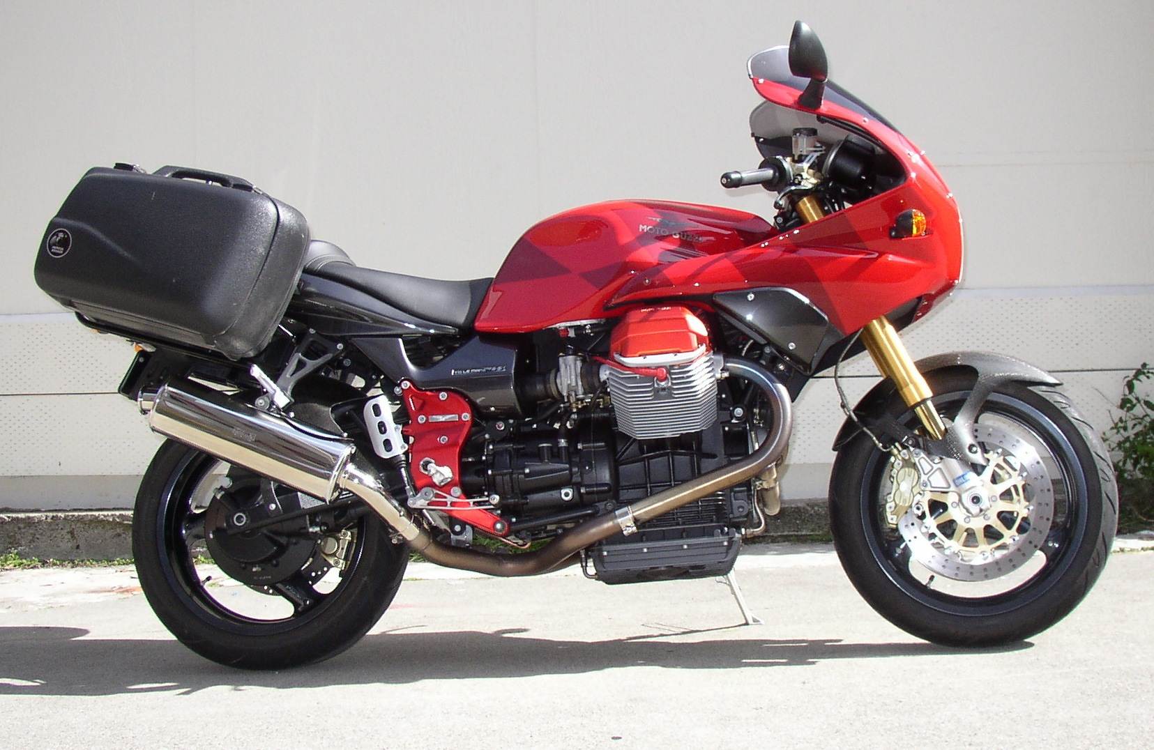

  1. OK Folks- I need to sell my Rosso Corsa. I had some bites last round but no-one closed the deal. Bought new in 2004, 10K. It has: Ohlins front and rear, new seals and oil in the fronts around 1K ago Staintunes, Stucchi crossover, PC 3 black box Stainless balance pipe gaskets new relays, pawl spring, 2k on Conti Road Attacks Taller windscreen, Hepco Becker rack and bags. Oil changes every 3K, trans and drive box oil at 8K. Injection balances and TPS set properly, tappets set per Raceco, drive shaft lubed, polished religiously, various fasteners replaced with stainless--owned and loved by experienced Guzzisti. I also have bar risers I never installed I will include. Its a beautiful bike, runs beautifully, sounds fantastic, just broken in,ready for spring. Lets take the price down to 7K.

  3. OK folks, I unfortunately need to sell my Rosso Corso. Bought new in 2004, 10K. It has: Ohlins front and rear, new seals and oil in the fronts around 1K ago Staintunes, Stucchi crossover, PC 3 black box Stainless balance pipe gaskets new relays, pawl spring Taller windscreen, Hepco Becker rack and bags. I also have bar risers I never installed I will include. Its a beautiful bike, runs beautifully, just broken in, but I have another project to finance, and I am keeping the Monza and the Breva (wife's bike). How about $8K ?
