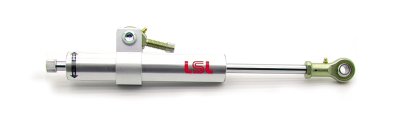

Hi, In my Sport 1100i I have a LSL damper from Stein Dinse : Artikelnummer 300042301 Lenkungsdämpfer LSL Alu L: 290mm/Hub:70 : 124,12 € It seems to work well and it is reasonably priced compared to Bitubo or Öhlins products. This one should fit also a V11. I did make some kind of a combination of the orginal Bitubo attachment parts together with those that came with the LSL. That was however only a 5 minute job. br, JuhaV
