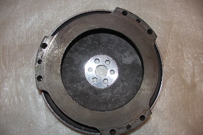

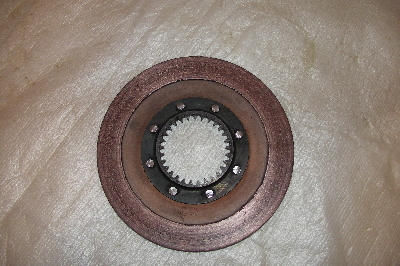

  10. sorry for the delay on pics here are a few. If the resolution is too low let me know and I will post some higher res ones elsewhere with a link
  11. Solo It cost me 2480 Aust. for parts As for having the flywheel tested I don't think so I am curious though and I will get some pictures up in the next couple of days for you. Tim
  12. frame no. ZGUKS00002M111836 Hope you get enough replies to see if there is some pattern. For anyone still running the single plate it is not a high mileage plate. That said at least replacing clutch plate, pressure plate should'nt be such a big cost compared to replacing the whole unit. Tim
  13. Uable to risk it any longer put the SCURA into the shop to have the twin plate unit installed. Picked up the bike today, feels good no more snatchy clutch. I bought this bike new it has 36k km on it with no sign of flywheel trouble. I asked the shop to pay close attention when removing the old unit for anything that was not as should be. The old flywheel shows no signs of fractures but that's only by visual inspection. The clutch plate on the other hand shows plenty of wear with approx. only 5-6k km wear left. The teeth on the clutch plate were also worn down to a point so while this had no caused any problems so far, it would have not to far down the track. So to all you SCURA owners out there this may offer some small peace of mind. I don't think it would have made any difference to my decision. If anyone wants a complete single plate unit just let me know and its yours for the the price of postage. Tim
