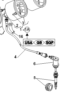

....never mind. Thanks Docc! The same thing happened to mine. I put it in a vice and all was fine. Part number 6 was starting to come apart, presumably because when it was reasembled, it was not keyed in, so when part 6 was tightened on to part 5, part 6 started to come apart leaving too much distance between moving parts. So, when you reattach part 6, be sure that everything keys into place!
So I just had the recall on the tranny done and 8 miles down the road the speedometer fails. When I get home I take the cable apart and everything appears to be fine. I can turn the speedo with a drill with the drill attached to the part between part 5 and 6, so all appears well. I suspect the part between part 5 and 6 is no longer long enough and that part 5 now sits too low. however when I measure it, it appears to be the correct length. I am confused. The other possiblility is that the cable or part 6(angle drive) is worn. Sometimes when I put it together it will work, and then it stops. I am going to try the drill test again and maybe take it back to the dealer. But right now, I think I need a bicycle speedo.
