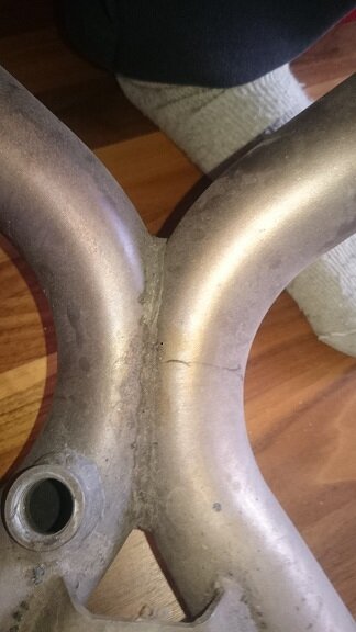

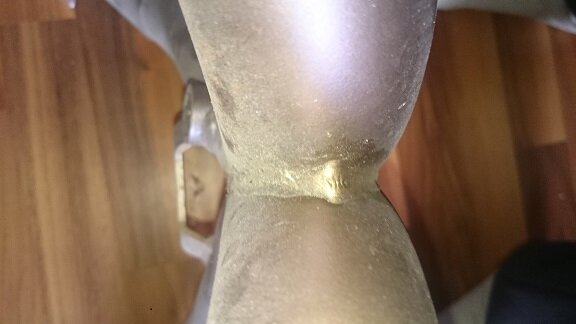

  5. I have looked as far into the pipes I could to see what's in there on all the middle parts (x sections/xovers/x pipes)I've gotten,so I'm curious about that too.I only have the Stucchi and this MASS x pipe part that I can take pictures of.The Stucchi you could guess that the weld is as wide as it is deep so maybe a little bit smaller than the welded part then. On the MASS part the hole is as big as the pipe ,but on the Stucchi it's not as high as the pipe itself but longer.

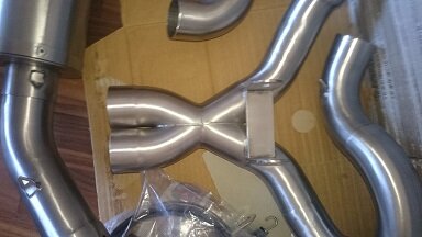

  12. Good to know the x pipe is supposed to look like that.I had only seen it on cars but had no idea what the design did for preformance.I thought that there would have to be room for some of the gases to go straight forward and some to be able to use the other pipe back and forth.And for that there was a need for some bigger area where they came together.But I guess not then.Perfect! When I ordered the exhaust system I asked for the same ID (42mm) all the way from cylinder to end of silencers with as big hole joining the pipes as possible. The aim was to keep the exhaust gases from not slowing down.To hopefully help torque on low revs. This looks very different from that Stainune exhaust that was the inspiration but it should work in quite the same way then.Great!
  13. Here is a picture of the xover connecting part: It looks like a very narrow area at the crossing point.I don't know what that will do to the preformance. My explanation to the people at MASS moto wasn't that great,so this part and the silencers + pipes are going back and they will do some changes,and put a hole in for the Lambda sensor.I'm not bothered because I'm waiting for the neck surgery to heal anyway.
