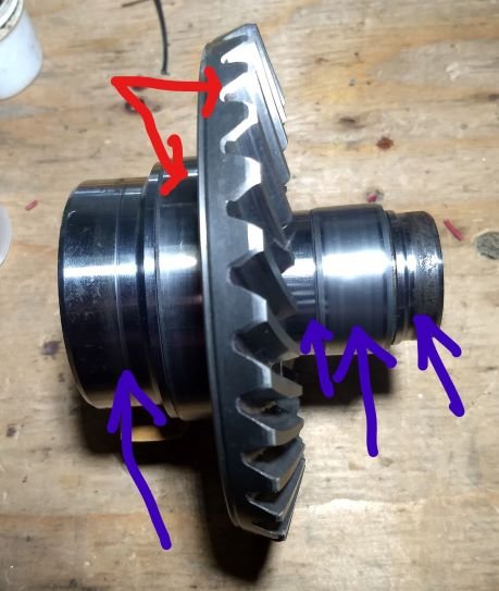

  4. the red arrows turn independently from the blue arrows
  5. Hi, nothing in the wheel is turning. It is only the big bevel gear (#29) that is spinning on its shaft
  6. 2004 Ballabio with close to 40K. Pretty sure this is not supposed to do this. I thought it was the clutch at first, but the driveshaft turns while in gear but the rear wheel doesn't. I pulled my rear box off and found the 32 bevel gear spins on its axis. Did I shear a key? Has anyone seen this before? I don't drag race all the time... I haven' been able to find the part. I may buy a complete assembly and rebuild. Does anyone have any thoughts? thanks in advance. VID_20210118_151646469.mp4
