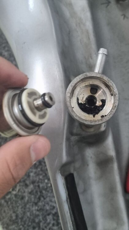

  3. Hi all. I'll update this thread so I don't create a new one. Recently, on the go, the motorcycle began to stall and lose power, I thought it was a problem with the TPS, but then I heard how, after the engine was turned off, fuel began to drain into the tank. As I understand it, the fuel pressure regulator does not hold. I took it apart and found pieces of some kind of plastic. I have no idea what it is or how it got there. Could it have been something inside the regulator originally and it fell apart?

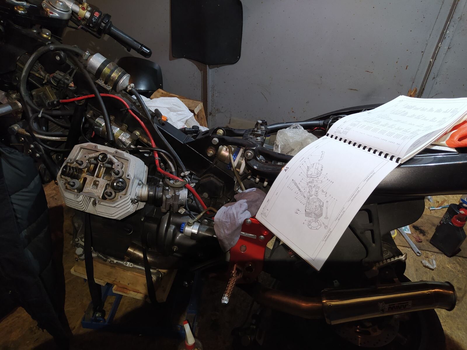

  9. Another problem After rain, the engine runs intermittently, as if the spark does not always fire. This already happened after the rain, but then after 10 minutes of malfunctioning the problem went away and he drove as if nothing had happened before the next rain and now the problem does not go away. The engine starts only with the gas handle open and stalls when the gas is closed (at idle). The engine itself works coughing and unevenly. Maybe there are places where moisture can get after the rain, which could lead to such consequences? I connect this problem with the rain, because it happens the second time after the motorcycle gets wet. I exchanged relays for working ones and before that I was pressing contacts. Grounding on the box is also ok. I inspected the candle high-voltage wires but did not find signs of wear. Valves have been regulated recently. There are cracks on the connecting horns from the air filter, but it seems to me that could not lead to such consequences. At the weekend I will check the readings of the sensors (TPS, temperature), the pump contacts (it is new). Maybe R.P.M. AND T.D.C. sensor? I found forum posts with a similar problem. Just until I realized how it can be checked. Glad to any advice

  11. I adjusted the valve to 0.15 / 0.20. Everything seems to be fine) Maybe in vain I started a discussion here, but we talked and you know that I know what TDC is
