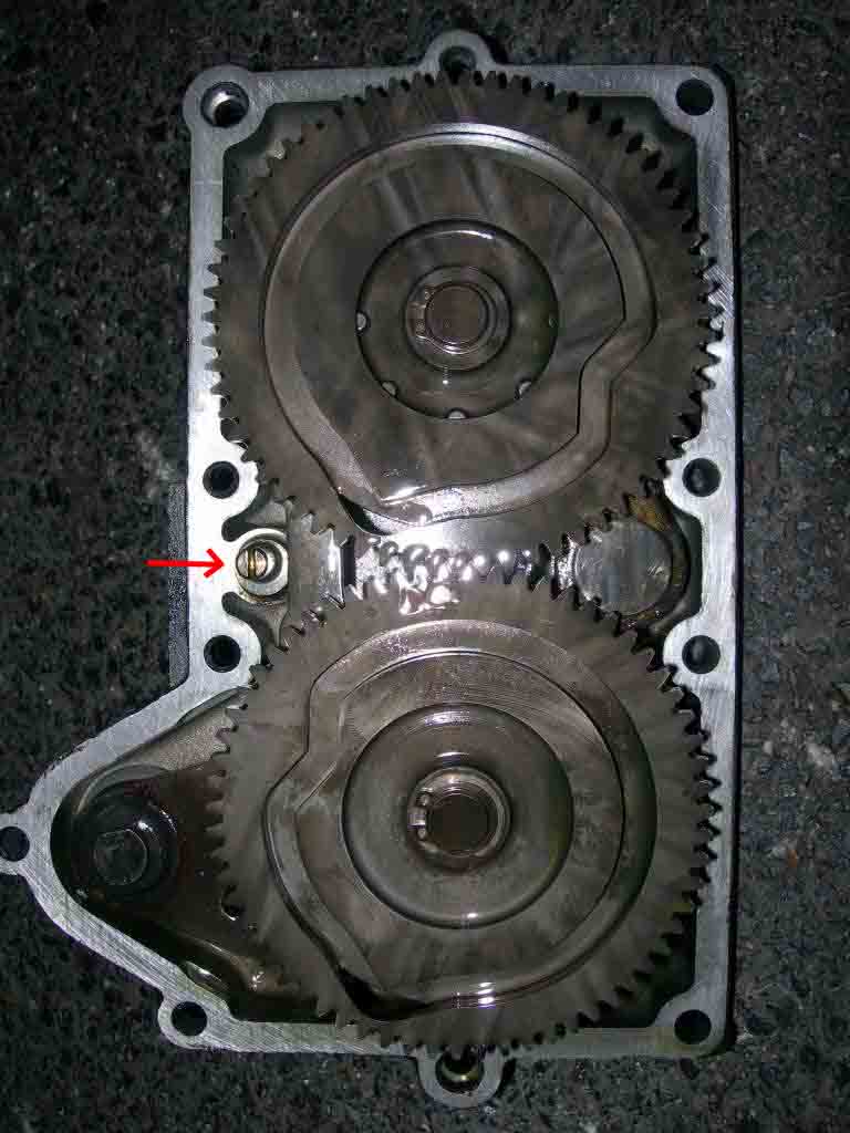

There have been a number of threads on this post / pin in the past – particularly because at least one person has found the pin in the bottom of their box after it had somehow come out.
Bbennett:
"You are exactly correct in your last post. I finally took the bike into Moto Int. in Seattle and they confirmed the roll pin had fallen out. They said I was lucky that it had not damaged anything upon exit. The bike is shifting perfectly again and my thanks to the Forum and to my dealer.
If YOU are experiencing a large number (1 in 8 shifts) going both up and down, please consider the possiblity that this pin has fallen out (see above post)." http://www.v11lemans.com/forums/index.php?...st&p=102785
also thmpr: http://www.v11lemans.com/forums/index.php?...ost&p=62930
roll pin stop:
adjustable post stop:
from gallo_se who is another person who posted on this
The post is adjusted to the opposite side from Doc's, though I suppose that it's giving the same amount of adjustment.
