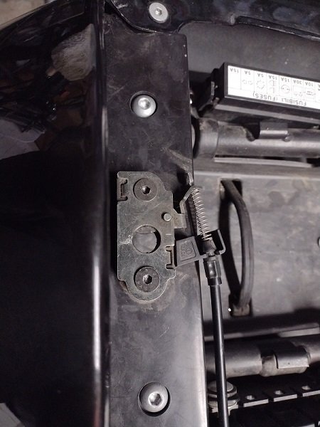

mikev Posted June 7, 2022 Share Posted June 7, 2022 This happened to me right after I bought my guzzi. The former owner and I started to take the back end apart and wasted a lot of time without success. I somehow found this forum post and based on all the responses, I solved the problem. Thanks Everyone! Like many others here, the root cause is the spring fell off the release latch. I have a fiber optic probe which I stuck under seat toward the very back on left side of the bike. The probe light illuminated the latch assembly. I slid ice pick in and triggered the latch to release. Once seat was off I wired the spring onto the latch to stop it from sliding off again. 1 Link to comment Share on other sites More sharing options...

worthyperformance Posted December 27, 2022 Share Posted December 27, 2022 ratchethack's 11-JAN-2009 post worked for me: "1. To get out of your current fix, reach underneath the rear of the right-hand side cover where it meets the muffler/pillion peg hanger, where you will find the cable shroud for the seat release. While turning the seat release key full counter-clockwise as you normally would, pull the cable shroud down about an inch or so. This will give the cable a few mm more travel, and release the seat. Since this takes both hands, you might need someone else to push down and pull up gently on the rear of the seat at the same time for it to work." However, rather than employing his long-term fix, I simply bent the latch arm a bit (+/- 3mm) so the latch completely opens when I turn the key (counterclockwise). My latch arm was bent a bit the wrong way anyway so the cable angle is ever-so-slightly better now too. 2 Link to comment Share on other sites More sharing options...
