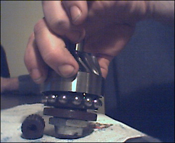

richard100t Posted February 25, 2007 Share Posted February 25, 2007 Its worth checking for play in the Pinion nose bearing while your there. http://www.v11lemans.com/forums/index.php?...=9794&st=15 then you'll have a decent spare should you need it. Well since my pinion gear had snapped off I'm not too worried about the old piece. Once I'm able to get it out I can take it to a local gear shop & have a new pinion gear made. Right now I'm wishing I had Pete Ropers very clever tool he made to get the castellated thing off. Link to comment Share on other sites More sharing options...

richard100t Posted February 25, 2007 Share Posted February 25, 2007 I'll try & post some pics here. Ok heres another (I hope) Now that I've gotten the thing out on the table, does anyone have some advice on how to get the pinion nut off? It has an indentation in it to hold it tight I suppose. I've tried to pry it loose with a very small screwdriver, but no luck. I'm not going to try & force it either. Although since I'm wanting to have a new gear made, I doubt that damaging the old one will matter much. Link to comment Share on other sites More sharing options...
