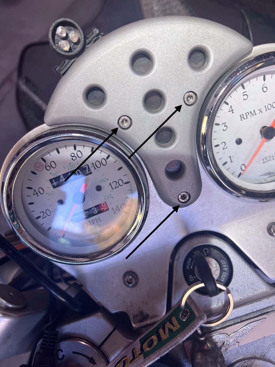

Sam P Posted 2 hours ago Author Posted 2 hours ago (edited) On 9/18/2025 at 4:59 PM, docc said: +1 on "Wiggle Testing." The corollary of my supposing that finding the charging fault may fix the light is: affecting the light may reveal the charging fault. Wiggling the key (turned on) and then the harness attachments to regulator didn't activate any dashboard lights. I was going to open up the dash to see if there were any loose connections or corrosion inside. Any tips on how to get in there? The three 3mm hex fasteners feel like they may be stripped.... Edited 2 hours ago by Sam P

Pressureangle Posted 1 hour ago Posted 1 hour ago 1 hour ago, Sam P said: Wiggling the key (turned on) and then the harness attachments to regulator didn't activate any dashboard lights. I was going to open up the dash to see if there were any loose connections or corrosion inside. Any tips on how to get in there? The three 3mm hex fasteners feel like they may be stripped.... Those screws pass through the mounting plate and thread into the plastic housing below (may have brass inserts, don't have it in hand) but you probably feel the plastic housing dropping away, which you can't see. 1
gstallons Posted 40 minutes ago Posted 40 minutes ago 1 hour ago, Sam P said: Wiggling the key (turned on) and then the harness attachments to regulator didn't activate any dashboard lights. I was going to open up the dash to see if there were any loose connections or corrosion inside. Any tips on how to get in there? The three 3mm hex fasteners feel like they may be stripped.... find a new form of entertainment because these ain't comin' out.
