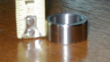

Is there any difference between the 01 & 02 inner spacers? I'm getting a 1/4 inch or so gap between the hub & the rim.
53024[/snapback]
There does appear to be a difference between the 01 & 02 hubs. The spacer for the 01 is wider than the 02. I have the rear drives side by side & there is less room in the 02 than the 01 :!: I guess I'm stuck for awhile yet :bbblll::thing: I wonder if theres a difference in the wheel gears too? Anyone know?
Link to comment
Share on other sites
The final drive is from a 2000 V11 Sport, the wheels should be the same, I had 03 wheels on the bike.
The inner spacer length is 12.5 mm long, (roughly 1/2 inch in length). The spacer should be able to fit inbetween the opening of a 13mm wrench. Measure your spacer to compare. Man, nothing is ever easy with Guzzi's :homer:

Hmm this is odd... ok they appear to be the same. Well back to the garage! Let me recheck things

For anyone who's following this thread. 1) I have an 00 & an 01 rear hub 2) the gears in the hubs are of different width but the spacers are the same length. this leads me to believe that the gears on the 00 & 01 wheels are different also. 3) the total difference is approx 1/4"...theres an 1/8" diff from where the spacer rests to the gear plus another 1/8" in the gear length. 4) the 01 is (deeper) than the 00 by this amount thus allowing a flush fit with that spacer. I would have to think that the wheel gear for an 00 model is "shorter" than an 01. However I dont have an 00 wheel to compare with my 01 . Should I get a spacer custom made so that the 01 wheel fits with the 00 hub, or is there a reason these two should not be wed? Lmao If anyone has an objection please speak now or forever hold your peace!
