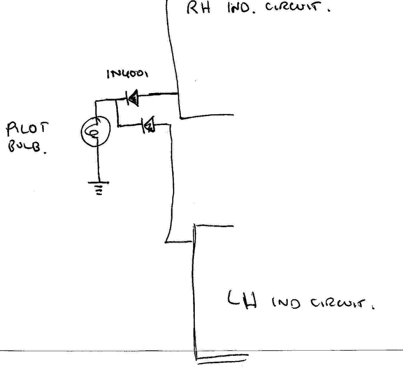

Guest Nogbad Posted April 29, 2006 Share Posted April 29, 2006 Slug, looking at your wiring diagram, it seems the dash light is connected across both indicator circuits, and this would have the effect you observe. In the standard set up, the dash light earths through the unused indicator circuit depending which way you are turning. With ordinary bulbs, the pilot bulb current is insufficient to light the main bulbs but IS sufficient to light a LED. To prove this, remove the pilot from the circuit. The indicators should then operate normally. I will post a solution shortly. Link to comment Share on other sites More sharing options...
Guest Nogbad Posted April 29, 2006 Share Posted April 29, 2006 OK, here is the resistor-free solution since you have a LED dedicated flasher. 1. Disconnect the indicator bulb from both flasher circuits and EARTH one side of it. 2. Connect each flasher circuit to the same side of the bulb through a 1A power diode such as an 1N4001. You need two diodes as each winker circuit must be blocked when the other is on. PS any old 1A diode with at least 50V RRM is good, all the 1N400x series for example. You can get these for about 10c each from Radio Shack. Link to comment Share on other sites More sharing options...
slug Posted April 29, 2006 Author Share Posted April 29, 2006 BrianG: Thanks for the input! OK, here is the resistor-free solution since you have a LED dedicated flasher. 1. Disconnect the indicator bulb from both flasher circuits and EARTH one side of it. 2. Connect each flasher circuit to the same side of the bulb through a 1A power diode such as an 1N4001. You need two diodes as each winker circuit must be blocked when the other is on. PS any old 1A diode with at least 50V RRM is good, all the 1N400x series for example. You can get these for about 10c each from Radio Shack. 87657[/snapback] Nog, may I take a guess that you're an EE? I did that test last night and removed the indicator bulb, and voila! Only one side blinks. On one hand, I think the design of the indicator circuit is a bit goofy, but then again, I'm sure the designers never considered that people would be using clusters of LEDs to replace the original bulbs, and after all, it is a Guzzi. Your solution is very close to what I'm planning to do I was thinking of replacing the bulb with an LED, something along the lines of this (just need to make sure I find a proper ground in the instrument cluster): Link to comment Share on other sites More sharing options...
